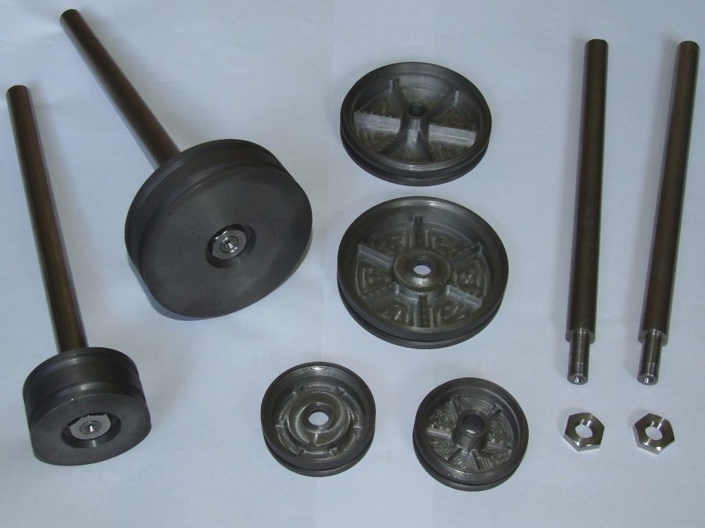

I didn't want the rattling "good" fit that would arise from using aluminium pistons in a cast iron cylinder block. So I designed and made hollow iron pistons:
The smaller piston is the same weight as an equivalent aluminium one, and the larger piston is lighter.

Andrew, I doubt you can make a bronze piston 1.25" OD * 1/4" ID * 0.5 thick, with a rim thick enough for an o-ring groove that would be lighter than a solid ally one. Even if you could, a hollow ally one would be even lighter!

Posted by duncan webster on 13/11/2017 09:51:00:
I don't know, you haven't given enough information for a proper design. smile
Andrew
JasonB13/11/2017 20:53:43
avatar
25215 forum posts
3105 photos
1 articles
You could just about do it with 1mm wall top and bottom and 0.8mm on the verticals, I would think that being a lot smaller than Andrew's the stiffening webs would not be required and would need to be silver soldered together rather than threaded. 25g all up weight for bronze and same for solid 6061
