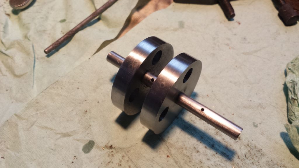

I have just made a crankshaft, 1/4" diameter, using loctite 638 to to bond it to the crank webs which are made from 5/16" mild steel plate. Same for the crank pin also 1/4" diameter.
Rock solid, I have pinned them as well with 16g panel pins but it was hardly necessary.

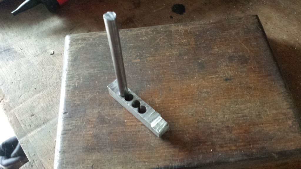

I thought I would share this with you. The first photo is a scrap piece of aluminium with 4 x 1/4" holes drilled through it. The end hole has a 1/4" round bar loctited in with 638.
I left this overnight and to test the strength I clamped the bar very tightly in the bench vice using soft jaws. I then tried to break the seal by rotating the alloy bar. The whole assembly rotated without breaking the joint. I tightened the vice more as hard as I could and the joint still remained firm. I was amazed how strong it was.
The second photo is the crankshaft for the Jepson engine, again 638 on the shaft and crank pine, and incredibly strong joints.

Geoff, is the round bar in the test piece aluminium or steel? if steel then that would have kicked off the reaction as only one of the two metals being joined needs to be active.
Hi Jason, it's mild steel, so a good point dissimilar materials.
As I had some 1/4" diameter aluminium bar last evening I bonded a short length in the other end of the test piece. I then repeated the test this morning, holding the bar tightly in the vice and rotating the test piece. This time after some effort I managed to crack the joint. So from that you could say that 638 is much more effective used on M.S. as your graph link indicated.
Neil's recent link in an earlier post was of interest, the flow chart on page 16 indicates that 638 was ideal for my jepson engine crankshaft.
I only pinned this crankshaft and crank pin as I had already pre drilled the 1/16" holes in the web. It's now what my Dad would have called " a right belt and braces job". All good fun GEOFF
