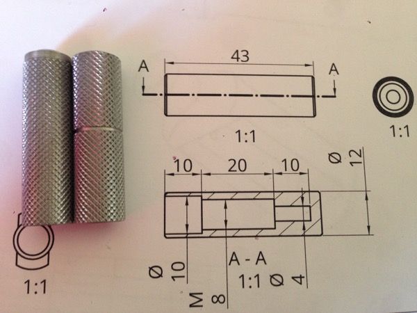

I have long tried to find nice tap-wrenches at flea markets, but have come short on the small sizes. I decided therefore to build one, well actually two, since one is for my father.
So far I have made the adjustment nut.
Adjustment nut

Pretty darn neat knurling. thumbs up

Neat knurling Benny; did you use scissor type tool or push on style ?

Thanks for the nice comments, I am quite happy with the knurling. Knurling has been fairly simple since I built my clamp style knurling tool. I also put some build images in an album.
Tonight I will start on the body of the tap-wrench.
Edited By Benny Avelin on 23/02/2017 12:59:13

Hopefully they will last me a long time, regarding dimensions, I really need to get better with dimensions of length on the lathe, the diameter is fairly easy to hit.

This is the drawing I am using, but for some reason not following very well.
This is the setup I was using for support when drilling the center hole, worked well. I like my starrett adjustable parallel.

I was taught hatched knurling was for knobs that needed pulling and straight knurling was for knobs that need twisting.But straight knurling seems to have gone out of fashion.

Regarding diamond pattern or straight, I agree completely that straight is for knobs that need turning since they won't be that good for pulling wink On a serious note I would consider the pattern for a rotating knob to be cosmetical as you can choose either one or the other. However maybe you have some knob that you don't taunt to get pulled then straight would be a better choice. I chose diamond knurling for two reasons, one is that I don't have any straight wheels here as I have left them at my fathers place, second I don't want to drop this tool with oily hands. smiley

I have a few tap wrenches to this design that I have acquired and they all have the same annoying problem. The pin that acts on the tap stems have all burred up. This isn't a problem when using smaller taps. The problem arises when you try to use it on taps that are at the maximum size for the tool. The burrs stop the pin retracting into the handle. At this point I usually throw the tool down in disgust and have to rummage around for a bigger tap wrench.
As you will own the tool from new you might not have the same problem. The guy that owned mine before I acquired them must have been an ape. 😉
You could make the 4mm pin out of silver steel and harden the tip. Just a thought.
