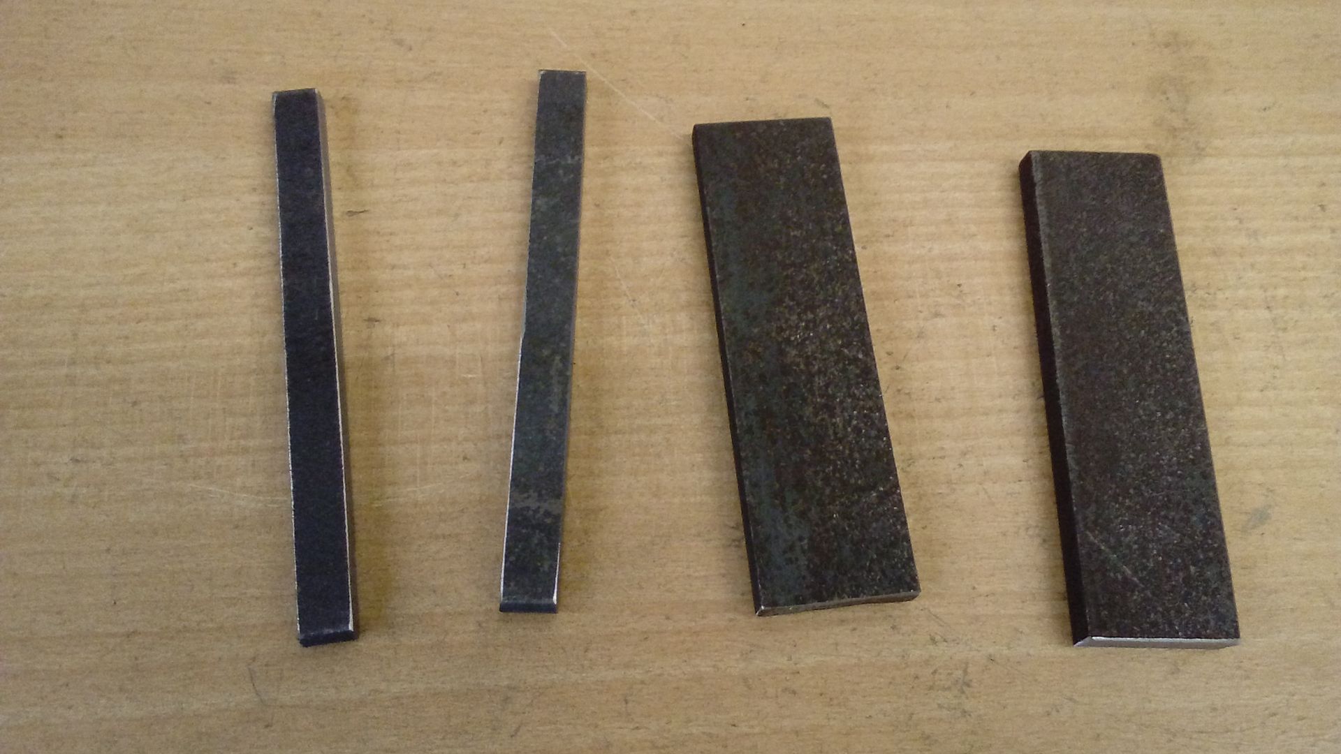

Even if you did come across 1/2" black bar it will likely have rounded corners so as I said in the other post mill it out of the next size up which is 16mm.
It is probably not quite so nice to machine as bright but is still best for the job.
Don't know if you saw my post yesterday in teh workshop progress thread but I showed some parts that are 5mm finish thickness, I cut them from a mixture of old 1/4" and new 6mm black bar that I had in stock. I also had 5mm black bar but chose the thicker material. They have not moved.
