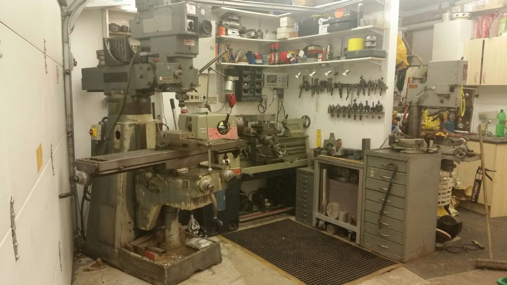

Alan Waddington 202/01/2017 19:40:20
537 forum posts
88 photos
Like many home workshops, mine has to have space related compromises, however the corner where the lathe and mill live just didn't "feel right" at all.......so today i got stuck in. Still many compromises but feels so much nicer already. yes
