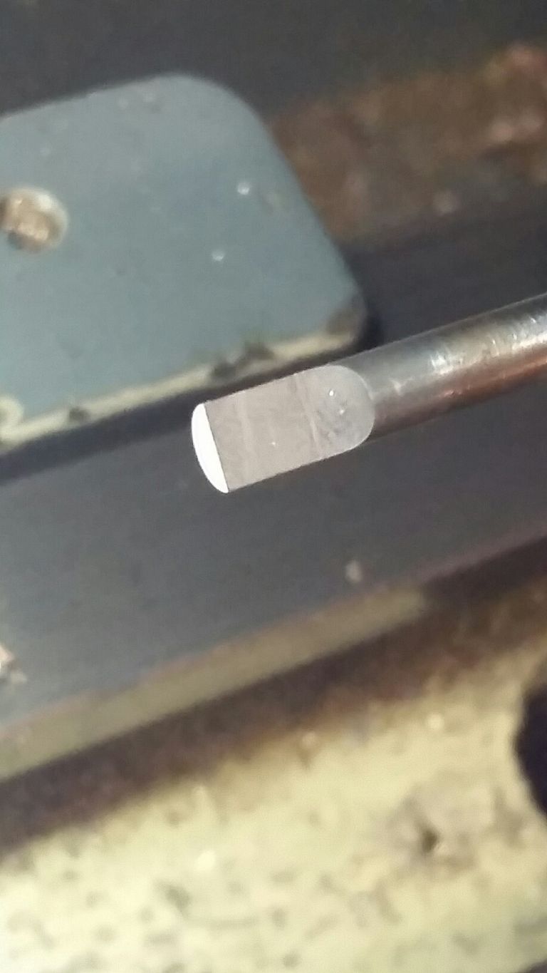

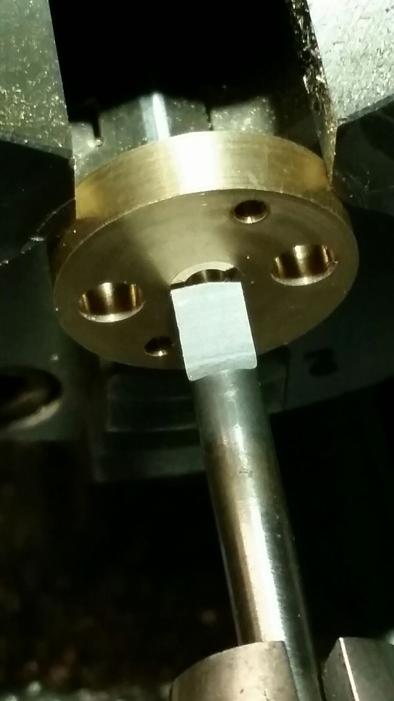

Peter Lamb 403/04/2020 22:10:17
5 forum posts
13 photos
This advice was really helpful thanks. I recently bought a D bit from a well known supplier but it had a flat end so just rubbed on the work piece. I've ground an angle as described here and it worked well. Before and after photos here. The part is the regulator valve for my Box Hill loco.
