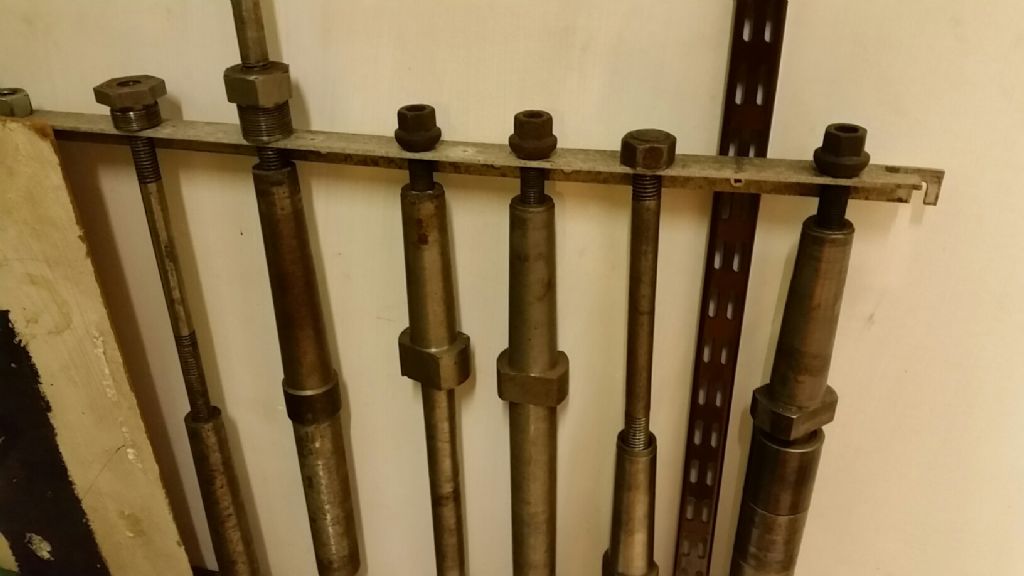

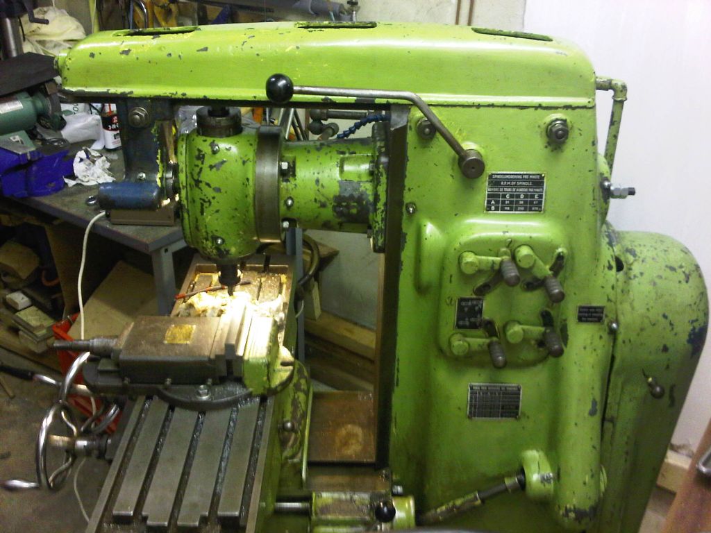

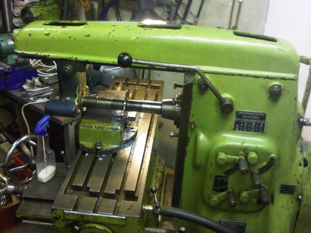

Hi Dan - I have a Pallas mill which is 4MT but also has the rectangular recess which matches all the tooling I have with it. Some photos of the mill in my album from a couple of years back. The torque to the tooling is via a combination of the friction of the taper and draw bar and the recess. Certainly when I am doing heavy cuts with the horizontal arbour on my machine the recess is closed up and helping drive the tool. Some of the tooling I inherited with the machine was made recently with the rectangular drive element so I would try and maintain this feature.Horizontal arbours

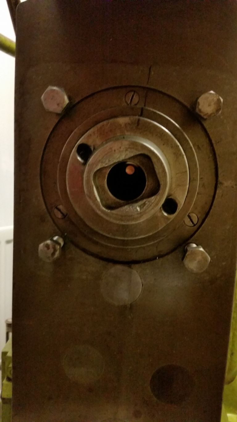

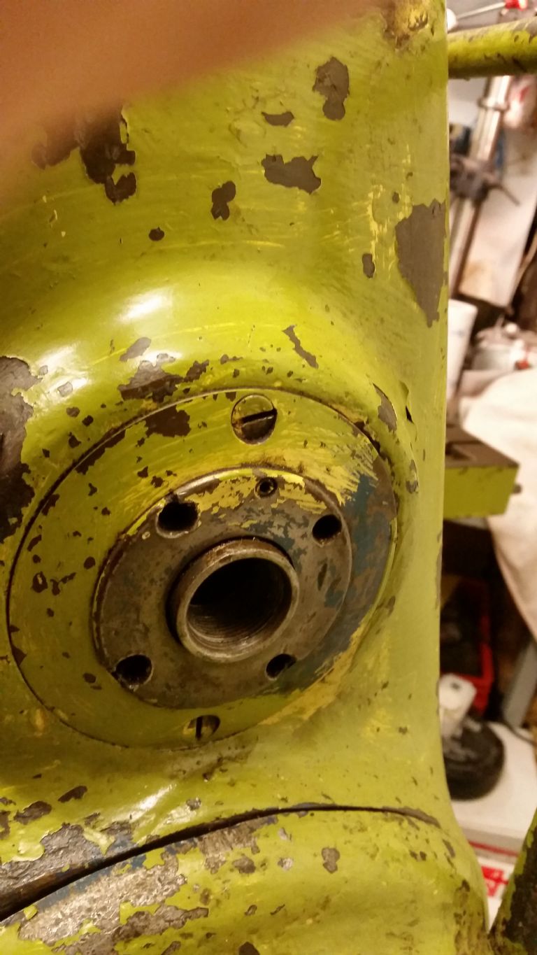

Thanks Dave. I think the arbours are clear of the shoulder but will check again - they do need a tap to free up so I think are home on the taper Ok. It has taken a slight beating over the years and I did need to clean up the "nose" of the spindle when I got it as the vertical head drive shaft had come lose on its draw-bar and run round out of the socket - the shaft was worst off but cleaned up ok.
12/12/2016 09:13:52
Thank you both for the advice and guidance. I haven't noticed any float on when checking with the stub shaft but will try again. This may well be my Christmas holiday job! I will check temperatures as suggested and can probably borrow an IR unit from work.

I am hoping someone may be able to advise me on how to adjust the main spindle of my mill. It is a Pallas horizontal machine that I think is 1950's or 60's vintage. It has no plate with exact details so I am working off information from the lathes.co.uk web site (the best I have found so far). There are some photos in an album I have created that will give exterior views - attached here. There is some run-out if I put a ~ 6" arbour in the bore which is 4MT. I have put a taper reamer down the bore and cleaned out a small high spot so I think what is left needs taking up on what I assume are taper roller bearings. I would like some advice before taking things apart if someone has done similar. Thank you
