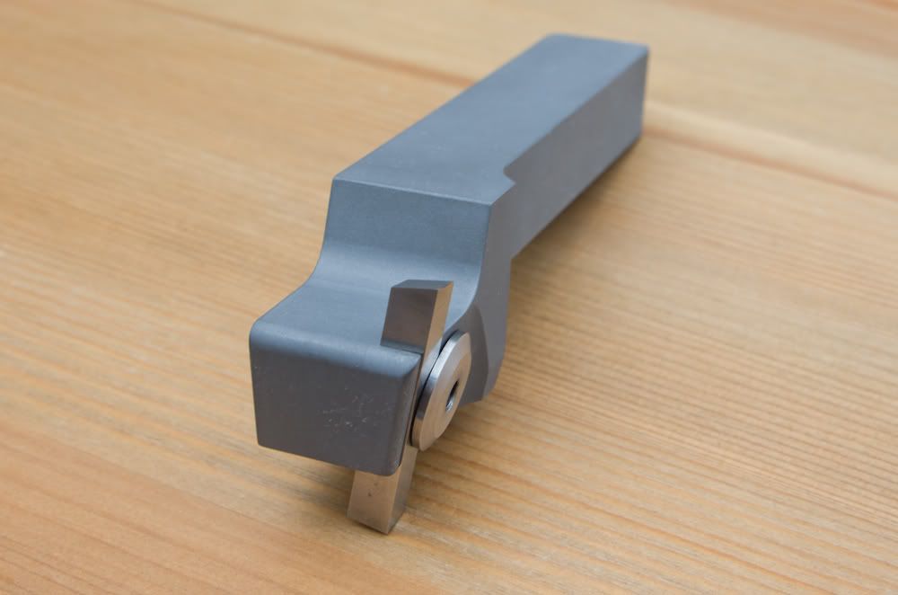

Vic04/09/2016 10:19:49
3453 forum posts
23 photos
Couple of pictures of mine in case it helps.

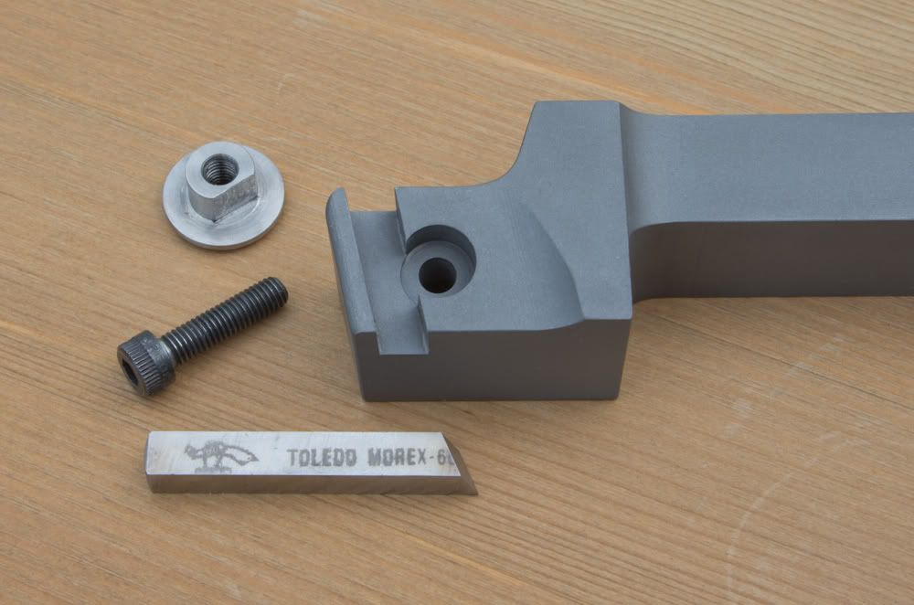

Vic04/09/2016 10:21:22
3453 forum posts
23 photos

Vic04/09/2016 11:57:57
3453 forum posts
23 photos
Sharpening jigs. The alloy one is mine. The black one comes with the Eccentric tool.

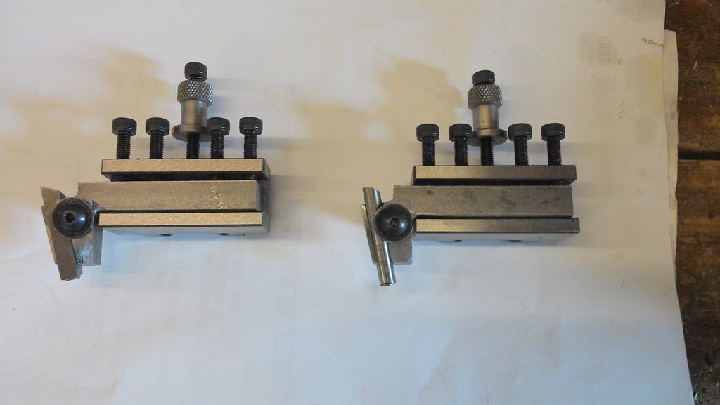

Thor 🇳🇴04/09/2016 12:15:51
avatar
1766 forum posts
46 photos
HI Andy,
Here is how I made mine. The first one I made for my smaller lathe, it uses 1/8" HSS tool bits since I had a box of them. I have since made another one for my larger lathe using 6mm HSS tool bits. They work very well, and as Vic has shown, it is easy to grind the tool bit.
Thor

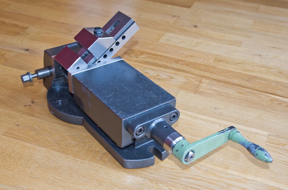

Vic05/09/2016 09:41:27
3453 forum posts
23 photos
I don't have a tilting or a swivelling vice. All I did to make mine was to swing my 4" vice round 12° to the table then mount a 2" vice in it at 12°. The work piece was then clamped in the smaller vice. Once the slot was cut and the hole drilled, tapped and counterbored the work piece was remounted in the straightened 4" vice and milled to size.

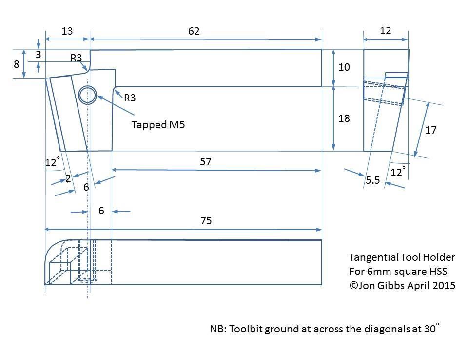

Jon Gibbs05/09/2016 10:11:51
750 forum posts
I made mine a while ago...
...but I'm currently investigating the Wimberley which I think has some advantages particular as a right hand hogger of material.
It doesn't need to hang below the bottom of the bottom of the tool-holder and the flank wear of the cutting bit is naturally ground off in sharpening.
If you get any flank wear with the tangential toolholder you sometimes need to grind off quite a lot of the tool tip to get below it.
HTH
Jon
