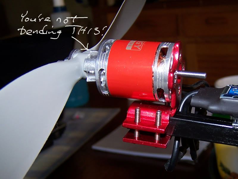

Ajohnw16/07/2016 16:29:17
3631 forum posts
160 photos
There is no side loading on these motors in normal use Neil. Just a prop so the shaft only takes thrust. The set ups have to be well balanced. New shafts and bearings have been available - for smash ups but I doubt if the bearings used last long.
The power figures are also overstated. Some give a most efficient rating which will be rather different to the headline figures. As amps and winding resistance are usually stated it's also possible to work out heat loss to some extent I^2R. Then there are losses in the controller and wiring. It wouldn't surprise me if the headline max amp rating was close to the fuse rating of the copper wire used for the windings or something of the order of a 10 sec rating etc.
This gives some idea how the higher power motors are sometimes used
Wot - no shaft used. Trouble is that it's still rotating on the inner shaft but doesn't bend so easily when they crash. Just add that this sort of set up could be improved by adding a more substantial bearing in a separate housing.
None of this really matters for their intended use as generally all that matters is the thrust the inevitable prop on the end gives in use. Different sizes and kv ratings are intended for use with prop's of a given diameter and pitch plus a reasonable flight time. There is bound to be info on this subject about on the net.
Worms and wheels aren't very efficient at transferring torque especially with high reduction ratios. Gears as per electric drills and angle grinders etc are better but noisier.
