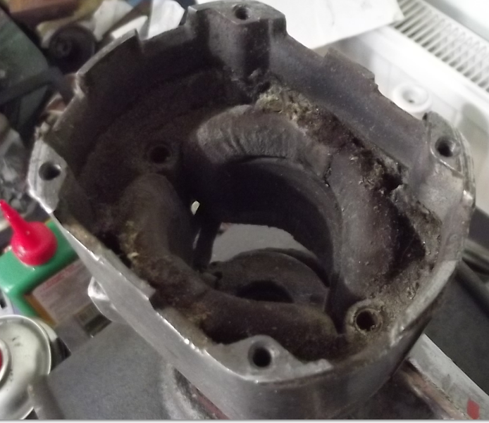

Recently picked up a Wolf Light Production Drill, partially because I am a sucker for Wolf (it takes my collection to 3 drills), partially because wolf drills are good when they work and partially because of the challenge of restoration (who can make a lathe if they can't repair a drill?)
Cable had been slightly pulled out the drill so it was immediately taken apart. Checks on the armature with a voltmeter show it is fine. Gears are decent. Casing is fine. Brushes still long.
Insides are completely covered in crud. Bearings have more grit than grease. Chcuk is a 1/4" CVA with a chuck key stripped of all teeth.

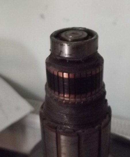

Q1
Whats the best way to get this bearing off the amature shaft? I considered prying off with a screwdriver but didn't want to bear onto the commutator. Feels kinda gritty so I want to replace with a new sealed for life bearing.

As previously mentioned the drill is full of crud. Most places that involved oil and tissue to remove but I thought the windings might be more delicate. Anyone know how to safely clean these out? I imagine the thick fluff layer could hamper heat dissipation or something.
Also anyone else have one of these?I'm struggling to place the green colour on the front. Want to spray paint it back to original when I get the chuck off.

Q1: It's hard to judge the size of this.
You might get a small 3 arm puller under the bearing.
Maybe some wedges made to remove JT2 Chucks ?
Heat and cold in the right places always helps.
Q3: I'd be careful of using harsh liquids or solvents.
The crud looks well caked on there, and who knows what it is.
Toothbrush. Plastic pick and some compressed air ? Prolly best not to breathe to much of the dust in....

Alex, It does not appear to me that there is enough space behind the bearing to clear the jaws of a 2 jaw or 3 jaw puller. I think a bearing separator is a better choice.
JohnPittsburgh Automotive 62593 Bearing Separator and Puller Set

In a past life I used to repair power tools, so the way I would approach this would be:-
Do NOT remove the armature bearing yet. Reassemble the drill, not worrying about the motor brushes. No need to remove the gearbox grease, or if you have already removed it, no need to relubricate it just yet. The main criteria is that it all turns.
Make up a rod, about 6-8" long, from steel bar or rod that you can grind the end down to be a snug fit in the hole for the chuck key in the chuck. Hold the drill in one hand, with the rod stuck in the chuck key hole, and give the rod a good whack with a big hammer. This should loosen the chuck which can then be unscrewed by hand. Sometimes several whacks are needed, but this is the best way to loosen screwed-on chucks. As John Reese has said, the inertia of the armature and gearbox will be sufficient to resist the rotation.
Then dismantle the drill again. As you thought, if you try to lever the bearing off, you WILL damage the commutator. What you need is the bearing separator shown by John Reese, but these are rather expensive for a one-off. You could probably bodge something up. The advantage here is that as the bearing starts to move, you can tighten the separator jaws under it, so getting better purchase on the bearing. If you cannot sort out something here, try to see if a garage or auto-electrician can remove it for you.

The best way to clean out the windings of all the accumulated crud in there is just to give it a really good blow out with compressed air. I would prefer not to poke at anything, just to give it a prolonged blow-out. Poking could compromise insulation that old, and anything left after a really good blow-out would probably not affect things too much.

In case you have not seen a bearing separator before, the main advantage of them is that they have a taper on the inside of the plates so that they can be slid under a bearing that has very little clearance, or much too little space for a bearing puller. Then as you start to pull the bearing off, and get more space, you can tighten the screws and pull the plates in further and get better purchase on the bearing.
It may be possible to bodge something similar, but I don't know what your workshop holds. Which is why I suggested a motor garage or auto-electrician as they do this sort of thing quite commonly. Someone else may have a better idea than me as to how to bodge something for this job.

Hi, I agree with Martin, put the largest hex key in the chuck and then use a copper/hide or other soft face hammer to give it a swift blow or two, don't use a ordinary hammer. Using a rod in one of the holes can lead to it flying around out of control. You should use safety glasses at least while doing this operation, with want ever method you use, but a full face visor would be better.
Remove the bearing with a puller as suggested or cut it off with care, using a cutting disc in a Dremel or similar tool. Do not use levers or wedges against the commutator, as this will most likely damage it permanently.

3.5mm dehind the bearing. 22mm od bearing. Will see what I can make cause bearing seperators seem to have a 30mm starting point.

If all else fails, cut through the bearing at an angle using a carbide cutoff wheel 9well several it will be!) in a Dremel type tool. This worked on a washing machine.

I've never seen a bearing puller small enough to get behind the commutator end bearing. I have used a Dremel to cut up the bearing and that can also very tricky to get the inner portion cut away without catching the com, proceed with care!. The field coils are removable and can then be cleans as necessary. When you use compressed air you blast the rubbish further in, when actually it needs to come out. Be careful when fitting new brushes, if you can bed them in using very fine sand paper . Paper side to the com, using a see sawing motion. Maybe I'm telling you some thing you already know. Hope not John

Since you are going to replace the end bearing ,can you not put it in the vice and tap the shaft thru' ? If the inner stays on ,do the same with that. Or have I got it all wrong again?

It being a single direction drill I think they skipped the inner left hand screw. All I can see down there is a lil nub that I guess is where the lathe centre was during manufacture. Put an allen key and whacked it counterclockwisewith a small hammer but it would do anything. I was about to post my failure here when I considered: What if I used a bigger hammer? Anyway then it worked. Thats one part down.
Also grabing the bearing with a vise is an idea. Unless anyone can declare how could have unforseen consequences I'm gonna go ahead and do that.

Hi Rainbows, two things really, there is a possibility of the bearing shattering with small splinters flying about if you tighten it up in a vice, so if you are going to try it, I'd advise you to wear a visor and anyone else who may be helping you to wear one also. Second thing, the bearing being hard may not grip very well in a vice and when you try to tap the rotor out of it, the whole thing may just skid out of the vice and hit the floor or other things and damage it especially the windings and or the commutator.

+1 on the gripping in vise and (carefully) pin punching shaft through brg method. Safety visors a must. A "catcher" / helper holding the armature as Nicholas mentioned is a very good idea too. Heavy gloves on the catcher/helper might be a good idea depending on your hammer skills. >ahem<
If this does not work or the outer shell shatters during the op then Dremel cutting the inner race is a good option. Just be careful not to nick the shaft or anything else nearby. A couple of wraps of low tack masking tape on the armature windings to protect them during butchery precision operations wouldn't go amiss either. Good luck JD

Don't like the grabbing the bearing in the vice idea, too much chance of things going wrong and causing damage. If the armature falls, the most likely thing to get damaged is the fan and that can be nearly impossible to repair.
The Dremel cutting disk is a good idea. If you cut a sheet of cardboard and slip it under the bearing it will keep the cutting dust away from the armature windings. Same thing doing the bearing inner race. Be careful but a very small nick in the shaft as you remove the inner race will not cause any problems at all. If you do, just smooth it out a little and put a new bearing on.

A steady stream of crud has been pouring out the windings when I was hammering bearings in and out of their housings reassembling then taking apart the drill again. Now its still got a layer of filth but lacks the big clumps it had before. Might not need anything more considering the risks.
