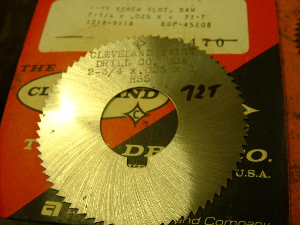

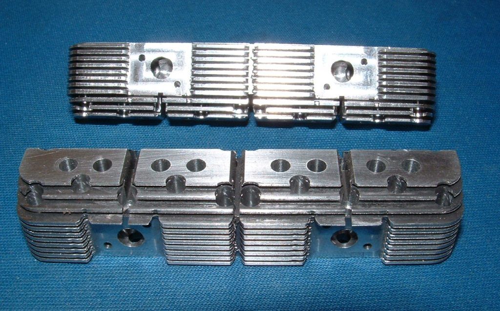

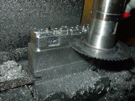

Eric
Selection of slitting saws I have pictured in my album and 2 below show the .025" thick 72T cutting cooling fins on a 6082T6 aluminium cylinder head. Like Andrew says make sure the gullets are kept clear or jamming will occur, I use mist and air immediately after the blade exits the cut, this keeps swarf clear and lubricates the blade. Tooth pitch for the blade shown is 0,120"
Adjust your DOC and spindle speed to suit the job and remember thin blades can easily run off-line if pushed too hard.

Pardon my intrusion but it's 72 teeth [total count], not 72 tpi
Emgee19/05/2016 09:37:15
2610 forum posts
312 photos
Yes Michael, for the blade pictured above tooth pitch is calculated as 0,120" which is a shade over 8TPI (8.3).

Nice work on the cylinder heads Emgee.........b
