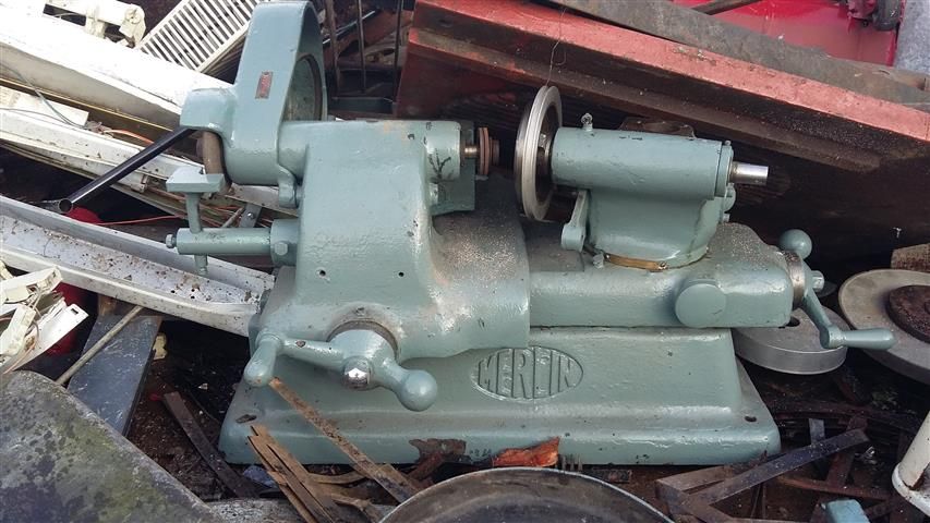

Spotted this partly buried in a local scrap yard.
I've searched the internet for information with no luck.
Any ideas?

Looks like a valve grinder ? Garages used to have them

hi ian it is a valve refacing grinder ,the collet holds the valve and is adjustable to different degrees the other end is for truing up the end , i have an american black and decker version which i have a modified fittining for sharpening drill bits , a very handy tool, i had one made by wolf years ago,but it may be old but it get used a lot , will

Think it's more likely to be a Diesel injector pintle grinder, Merlin made various machines for Injector and pump servicing.

No it's a valve re-facer.
Used to have one at the truck garage and a B&D one.
The motor is missing from this one.

To me, it looks like an excellent basis for a Tool & Cutter Grinder, and I would welcome it with open-arms.

michael thats what i have done i can now sharpen tools /drills /cutters with my modified h hall version made from his drawings and i still use it for valves on the old panther motorcycles that i repair i find it being used at least once a week , will

So it's a valve grinder then.Thanks to every body for your suggestions.

Never abandon good machinery to the melting pot. Someone will find a home and a use for it. There looks to be a standard wheel and tool rest at the left hand side so maybe it's not a valve surfacer after all. ?
