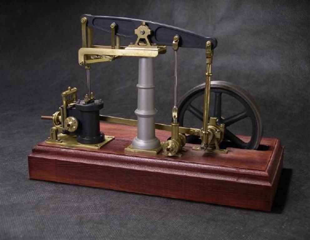

I am getting a bit ahead of myself here but this will be my next project after the Stirling engine is finished.
1. How do I make the main pillar ? Would you make this as one piece or three pieces ?
2. How to get the smooth taper on the flywheel/main beam connecting rod ?

The column is probably cast to shape but if not then its just a case of uurning various diameters.
Have a search for "fishbelly" as I did a post about how to do them, may have been Garry's my little engine thread.

You may find, the taper is two tapers joined end to end at the thick part with a radiused bit in the middle. Turn one taper and then flip end to end (Between centres), turn second at same setting and join with a file.

Read the posts from 11-1-2014 in this thread I did some sketches to show the steps involved in fishbellying a rod.
If the column is not cast then its just a case of holding a bit of round bar in your chuck with some tailstock support and turning the various diameters and then either using cocave or convex tools or eveb a file to add the mouldings This is one I did out of steel that is about 8" long, sorry no in progress photos.

Jason : So you used a file to add the mouldings ? I could not see how it might be done with a lathe tool. Thank you for the links. I now understand how the fishbelly is made : more freehand work. So I am going to have to buy a smooth single cut file from somewhere.

IT could all be done with a file but better to do the basic shaping with a lateh tool first, think of it like a small version of that rounded piston end that you did. Its quite easy to grind up a shaped tool like this and if used on both sides would produce a half round and then just blend with a file.
I don't have any single cut files but manage perfectly well so save your money.
