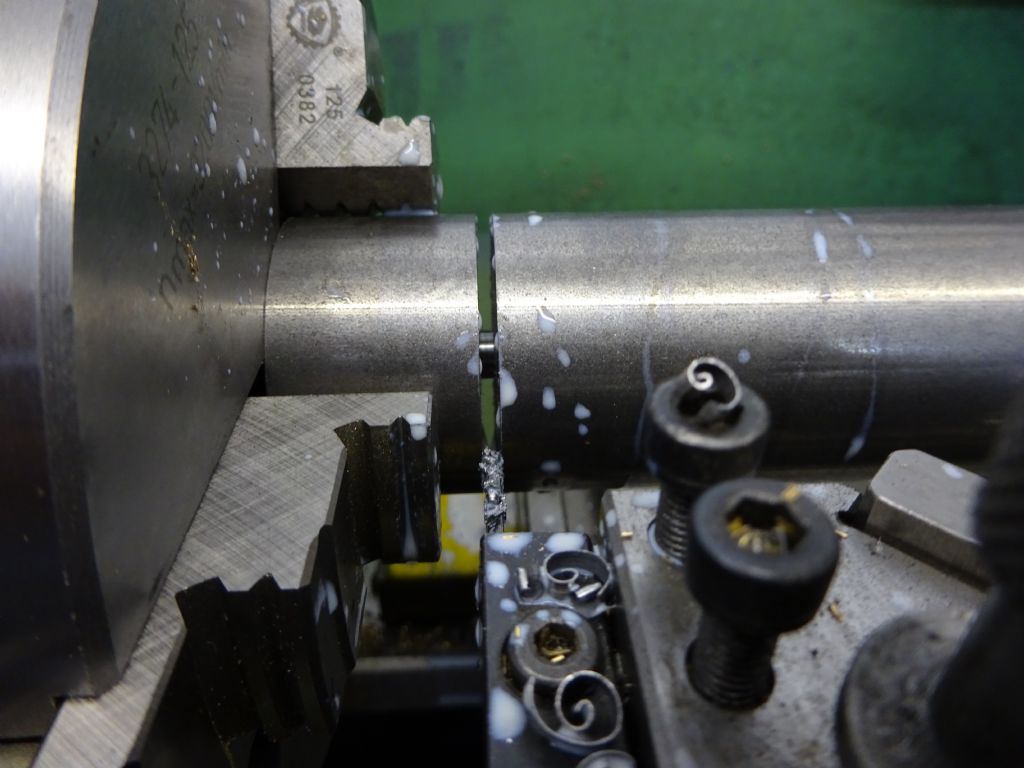

Hi all,
Am struggling to part off generally, but at the moment specifically some 35mm EN3B. Have tried several different tools - normal hss, chipbreaker hss, glanze carbide tip, and also in both front and rear toolposts.
Lathe is Warco 290v (150mm centre height)
Have steady stream of soluble oil on it, have tried speed from 150-500 rpm, and both hand and power feed.
Some combinations cut ok, but all end up with regular dig ins, resulting in motor stall.
There is a bit of backlash on the cross slide - I can manually push it back and forwards about 0.3mm. Could this be causing the dig ins with the tool getting sucked into the work ?
Any thoughts gratefully received.

I can probably move my 280 topslide a similar amount but don't have problems this is a bit of 40mm EN3B, about 400rpm, Glanze tool, brush applied soluable oil, power cross feed

JasonB19/01/2016 19:57:48
avatar
25215 forum posts
3105 photos
1 articles
0.0015"/rev or about 0.04mm/rev

John Reese19/01/2016 20:47:41
avatar
1071 forum posts
The tool position is far left of the cross slide ways. I suspect the whole topslide is deflecting to the left causing the tool to drop. Can you reposition the topslide to keep the tool over the cross slide ways?
JasonB19/01/2016 20:51:27
avatar
25215 forum posts
3105 photos
1 articles
John if you are refering to the photos then thats my machine that parts with no problem, we have not seen Dan's setup.
Dan Carter19/01/2016 20:52:22
81 forum posts
8 photos
John,
You mean in the pictures ? They are from JasonBs successful set up, not my failing version. Having said that, mine is similar, but not the rear toolpost version, in which the tool is inside the left t-slot of the cross slide and has the same problem.
Regards,
Dan
John Reese19/01/2016 20:53:09
avatar
1071 forum posts
The tool position is far left of the cross slide ways. I suspect the whole topslide is deflecting to the left causing the tool to drop. Can you reposition the topslide to keep the tool over the cross slide ways? In my opinion the parting tool holders have far too much oberhang.
I had similar experiences with my South Bend 10K. I decided to use the HSS parting tools that fit the Aloris style tool posts. There is far less overhang and if something goes wrong I just re-grind my tool.
