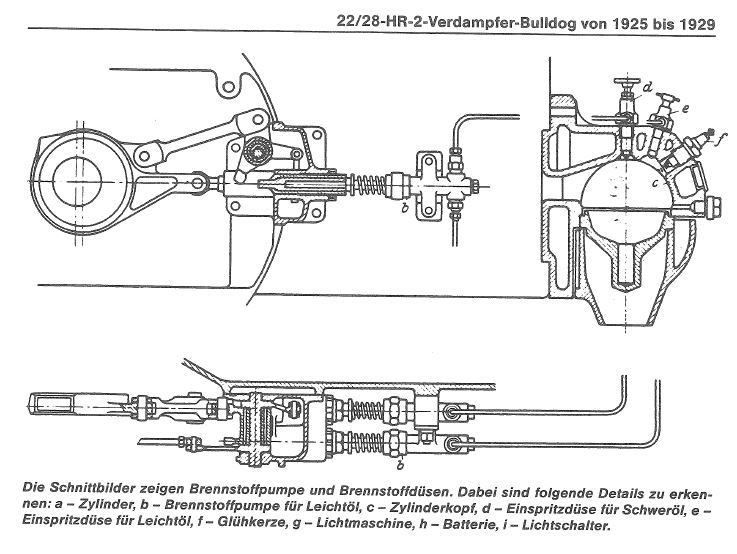

I checked when I got home last night and found I had quoted the wrong book. The fuel system is in “Lanz von 1859 bis 1929” the previous volume by the same author.
The opposite adjustment of the injectors for the Lanz and Bolinder engines is due to the different layouts.
The Lanz injects across the hot bulb into a well. When idling the fuel jet is narrowed so it just goes into the well where it is vaporised and ignited. This small well will stay hot enough to maintain ignition. Under load the fuel jet is widened so that the fuel hits a wider area of the hot bulb giving a larger area for heat loss. The book notes that if the driver did not widen the jet when running under load the engine would suffer from pre-ignition and loss of power. If the jet was not then narrowed when the load was removed the bulb would cool and the engine would stop. A few minutes at the “wrong” setting was not a problem.
As Stuart Bridger notes the Bolinder injected through the hot bulb into the cylinder so in this case widening the jet will cause it to impinge on the hot bulb heating it up for slow running. Narrowing the jet allows it into the (water cooled) cylinder when under load.

The Lanz Bulldog was able to run on a wide range of fuels, some of which required different cylinder heads, water injection or fuel preheaters. This list gives some of the variations and is it is described as for a 45 HP Bulldog I would have to assume it was a 10 litre engine. This would give a range of compression ratios from about 6-1 to over 10-1. The book suggests the normal compression ratios were between 5-1 and 6.5-1.
Injection timing is also a little difficult to define. The injection pumps were driven by eccentrics and in the case of the early engines the stroke of the pump was adjusted by a moving wedge which would alter the timing. The later engines moved the axis of the eccentric which would have a similar effect. Kurt Häfner states the timing as 120° to 135° before TDC.
The early tractors had an electrically assisted start system using an electric glowplug and a separate fuel pump and injector for what was described as ‘light oil’. The engine was still turned over by hand using the steering wheel. As you say the later tractors, especially the road haulage ones (Eil Bulldogs) used petrol in the second injection system and a sparking plug and trembler coil together with an electric starter motor. In both case when warm the engine was switched back to heavy oil. The units with an electric starter had a rev counter with a red area below 0 to warn you that the engine had started running in the wrong direction. It was assumed that if you had hand started the engine you should know this anyway.
