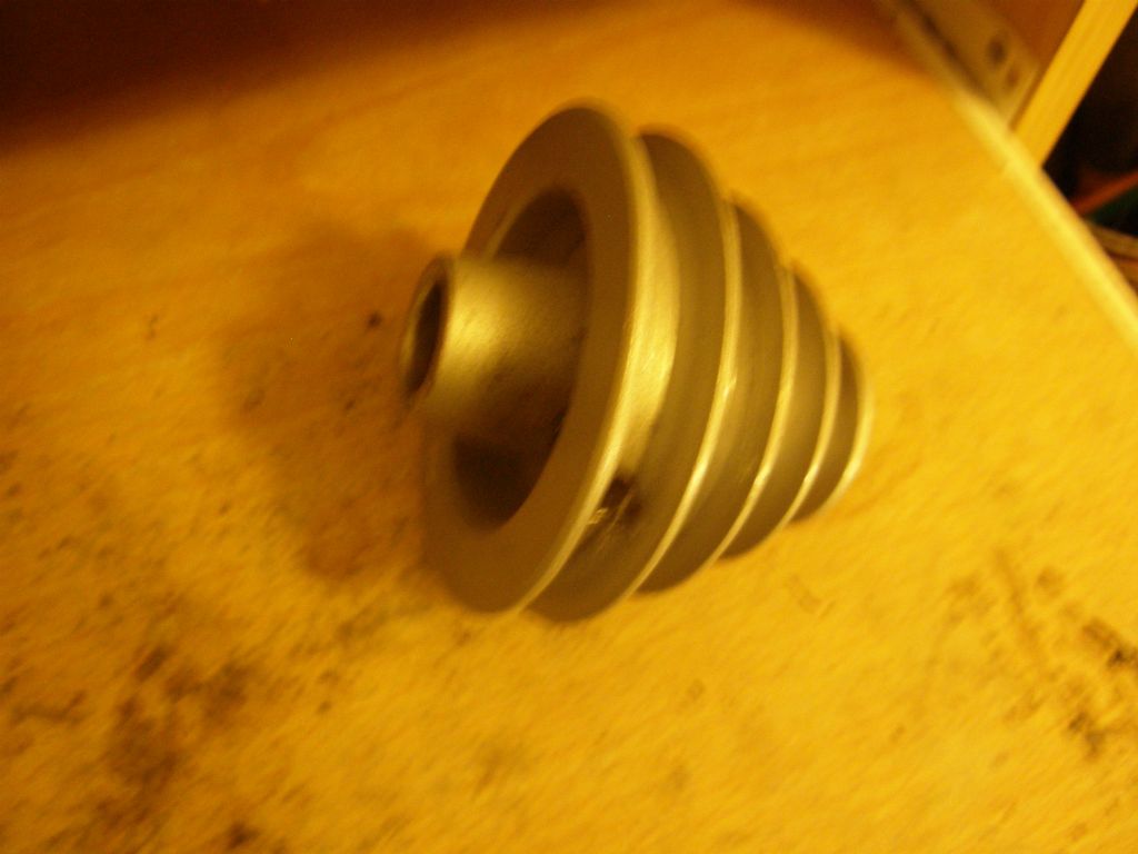

I have a step pulley from my drill press, which I don't use much since I got my mini-mill. I want to fit it to a motor I have.
The motor has a 14mm shaft and 5mm keyway. The pulley is slightly too big for the shaft-around 15mm inside diameter. It does not have a keyway.
If I want to cut a 5mm keyway in the pulley I assume I need a 5mm broach. Can I do this in the milling machine (Sieg SX2) by hand, by putting the broach in the chuck? What size keyway bushing do I need?
How exactly do I do it? Also, will it work given that the internal pulley diameter is slightly bigger than the shaft on the motor? The pulley is just the size I want, so it would be a pity not to use it.

You will need a bush whatever you do, so incorporating the keyway in the bush will make life easier.
If you can mount the pulley in your lathe, I would bore it out to 19mm and fit a 19mm OD by 14mm ID bush in it, with a 5mm slot cut for a keyway in the bush. use a strong retainer and you should be OK.

Sleeve the pully down to 14mm which you will have to do anyway then broach the pully complete with sleeve using a 14mm bushing.
You will need a tall mill if you are going to use it to push a 5mm broach through, if the pully is aluminium then a drioll press will just do as the broach can go through the hole in the table
You could save yourself £50 on a broach and bush by doing it with a simple tool in the lathe, these 4 3/16" (4.7mm) one in steel were done that way

Well, first you will need to sleeve the pulley to match the motor, otherwise it will be impossibly unbalanced. (Or sleeve the motor shaft to fit the pulley!)
You don't need a broach. I cut a 3/16 keyway in a steel bushing for a pulley by...
  • Mounting the bush concentric in the lathe (actually it was already there having been turned and bored to size) - so likewise mount the pulley concentric in the 4J
  • Making a shaping tool to fit a substantial boring bar I already had which gfaced the "wrong way", i.e. the cutting edge faced the headstock and was the right width for the key
  • Fitting the boring bar to the carriage at centre height
  • Using the lathe as a shaper, locking the headstock and cutting the keyway by using the rack to apply the cut and slowly applying the feed on the cross-slide.
It took a long time but worked fine and the keyway was perfect. It now applies the drive from a 3 phase motor fitted to my VMB, the bush being loctited into a larger hole in the pulley.
You could probably replicate this by mounting the boring bar in the mill chuck, the pulley on the table, and using the manual rack-and-pinion drilling feed to apply the cut, moving one of the table slides to increment the depth.

p1015410.jpgp1015409.jpgI don't have a lathe.
How do I sleeve the pulley to match the motor shaft?
I would need to buy a boring bar, but I am sure it would come in useful. Should I use the R8 taper on the mini-mill? I have added some pictures-they are rather big!

There is a simple way of cutting a keyway that does not need a broach. Having to fit a sleeve might make it harder to do, but the idea is that you turn up a slug of the same sort of material as the pulley and fit it into the hole, flush with the face of the pulley. Then you make a centre pop mark and drill through with a size just a little under the desired size of key. Take out the slug from the centre, now you have half a hole where you want the keyway. Next you take a small square file and file out the corners. As you get closer to the size, use a piece of key steel to gauge the fit.
The idea of using a slug of the same material is that it stops the drill running off, as will happen if you use a piece of steel in an alloy pulley.

Easiest way without a lathe is to get a bit of bar, lets say 3/4" as that the nearest to 19mm if you can't turn it. set up a length in the mill pointing upwards and drill/ream or drill/bore a 14mm hole down the middle.
Now mount your hollow bit of bar horizontally in the mill vice and mill a 5mm slot right through it on ctr line so its like a "C" shape.
Now set the pully onto the mill table and bore out to fit the piece of bar
Loctite bar into new larger hole

I'm not sure why the suggestion was 19mm specifically. The key point was to avoid difficult keyway cutting. If you had a 19mm outside, 14mm inside bush you can, before putting it into the pulley, mill lengthways a 5mm gap right through the wall, maybe as a slot leaving a bit each end to hold it in shape. Then you glue it into the pulley and hey presto a keyway is formed. Depth is (19-14)/2 or 2.5mm.
You can make the bush in the mill if you have a boring head (not a boring bar) and can firmly hold a bit of rod vertically. Don't forget a boring head can just as easily machine the outside of a vertical cylinder as the inside of a hole. Other options exist if you have a rotary table and no boring head but if you have a mill you will have to get both some day.

That, I think, is what i suggested in the first place.
Here's a drawing:
