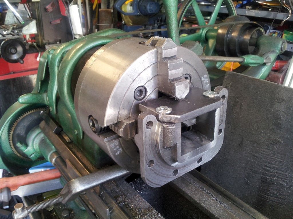

The housing was a difficult shape to hold in the lathe, so I made a temporary plate which was bolted to 2 of the mounting holes and held it by a 4 jaw chuck. Then turned the location diameters which fit into matching holes in the engine horn plates.

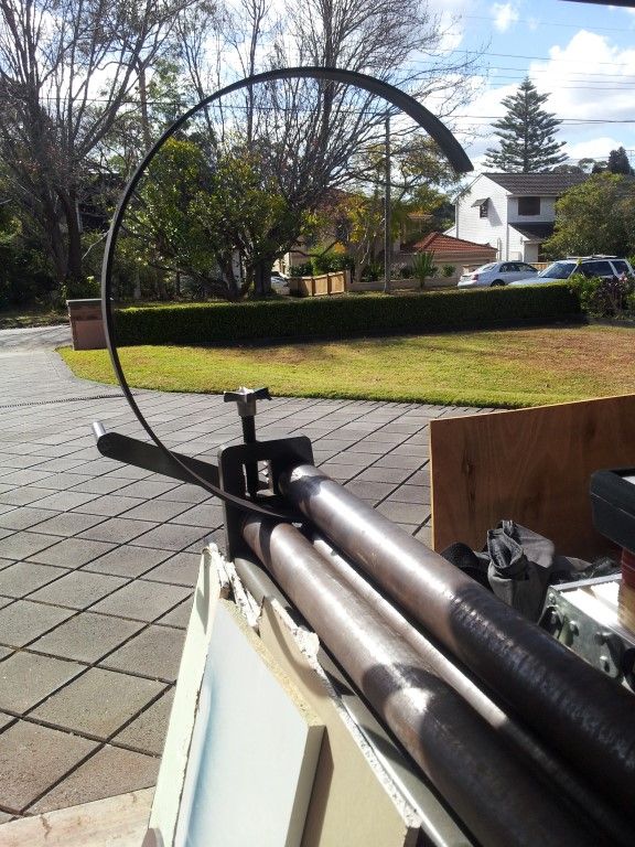

The steel rings for the wheel brakes were rolled from 32 x 8mm flat bar in 2 pieced. (easier than trying to make a complete circle) and plug welded to the inside of the wheel rim. The brake rings were rolled to a close fit with the rims then clamped in position to make an exact match with the rims and plug welded.

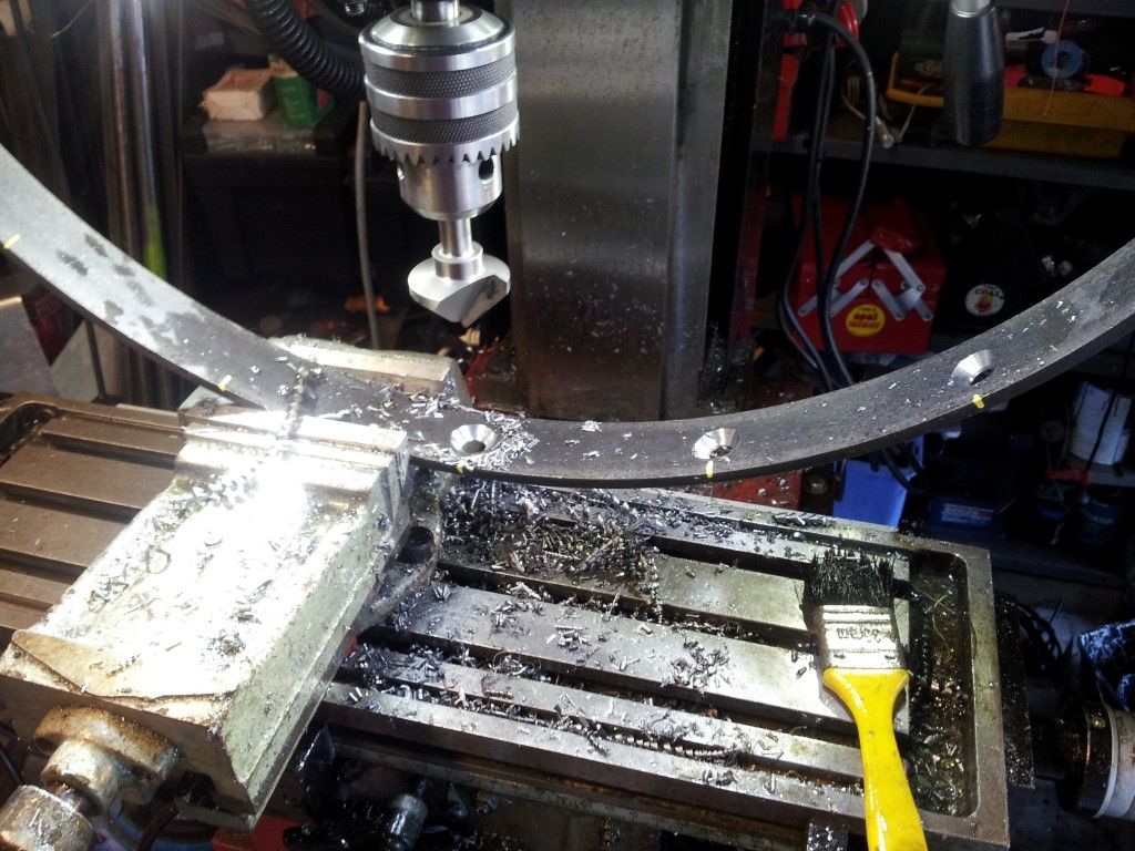

Drilling and countersinking holes for plug welds.

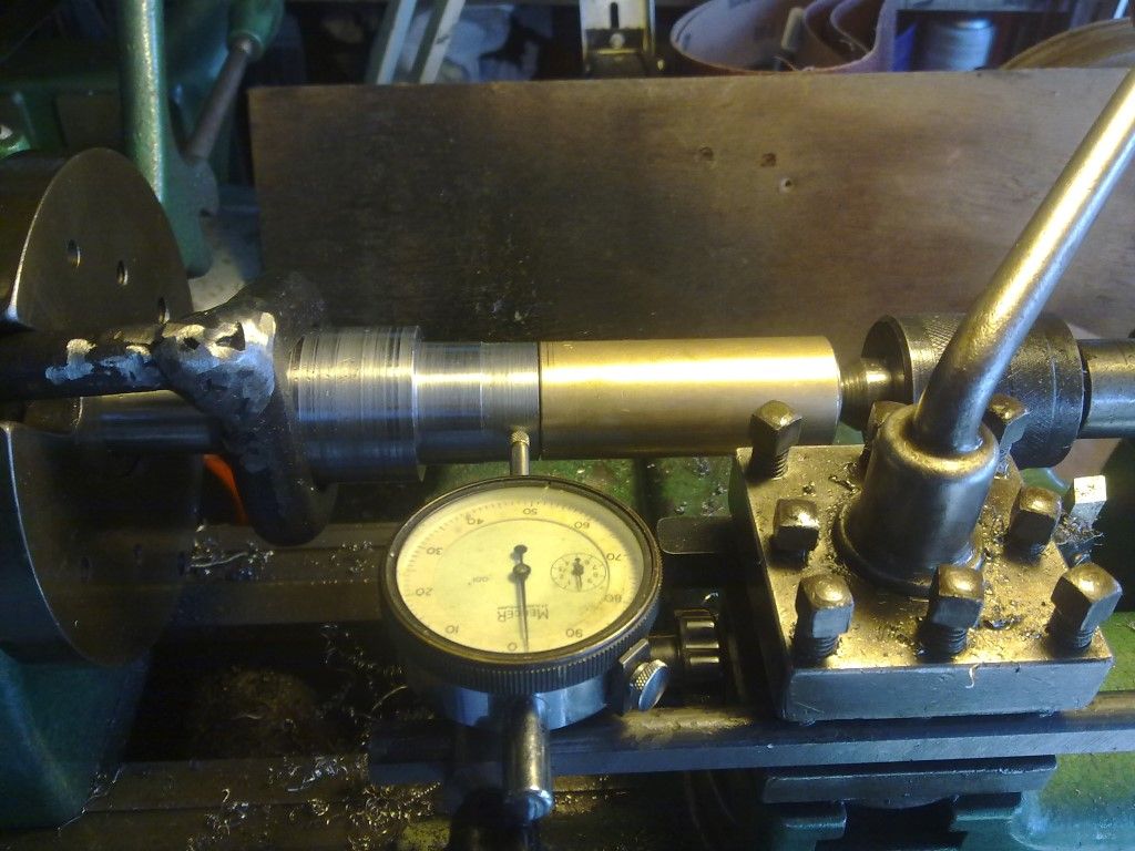

Soft soldering of bearing halves has never worked for me, for some reason. sad So as an alternative I made a jig that located both crankshaft bearing castings and the crankshaft bearings:
That way I ensured that the bores are co-radial with the circular location features on the castings and that guarantees the whole shebang lines up when bolted to the hornplates without the need for line boring in situ.
Andrew
