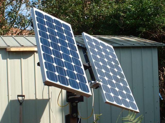

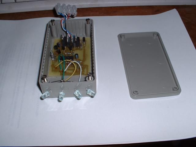

Back in the days when I was playing about with solar panels and wind turbines I built a solar tracker for two panels. I forget where I got the circuit from but it used 4 LEDs as photo sensors that drove a geared motor. The panels were mounted on an equatorilal mount that I bodged up from an old telescope mount I made years ago.
Very simple circuit and it tracked the sun perfectly. When it got dark it automatically drove the panels back to facing east ready for the next day. The mount was fitted with limit switches to prevent the panels moving too far.
The angle of elevation was adjusted manually every week or so by a threaded rod.
Used the panels to charge a 12 volt battery. I ran the house lights off it via an inverter until the battery was knackered. Was fine in the summer but the panels couldn't keep up with the winter demand. Not enough sun!
