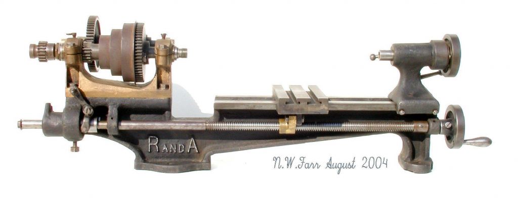

Nicholas Farr17/10/2015 10:04:29
avatar
3988 forum posts
1799 photos
Hi John, Rod could be on the right track. Although the badge RandA didn't seem to be used on production models, I have one where the RandA badge is cast into the bed, however the headstock is a separate casting and is made of bronze or maybe gunmetal. I have no idea if this is how it was made like this at the factory or if someone who had it originally broke the original headstock and had a new one made and fitted it to the bed after cutting the original one off, but it was shimmed up with a W.D. & H.O. Wills Woodbine cigarette packet and a short piece of thin copper.
Bond's O' Euston Road did the same model and called it the "Bond's Maximus" which was apparently a slightly modified Portass Model S **LINK**
I have more photos of this RandA I have, so if you would like to see them let me know.
Regards Nick.
P. S. I don't know what year the advert for the Bond's lathe is from, but in the same catalogue castings for a few of LBSC locos where available including "Olympiade" which was described in Model Engineer from July to December 1938.

Thank you gents, so many similar lathes around. Seems they supplied many firms who badged or reworked them.
It's down to the details of the casting and fittings.

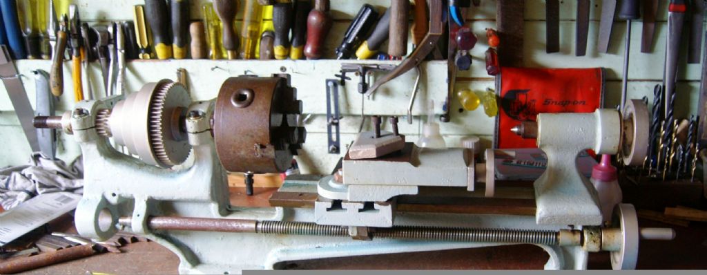

john carruthers21/10/2015 07:42:19
avatar
617 forum posts
180 photos
Getting there, he's cut some Vs in the 3 step pulley, mmmm.

Michael Gilligan21/10/2015 08:13:03
avatar
23121 forum posts
1360 photos
Posted by john carruthers on 21/10/2015 07:42:19:
... he's cut some Vs in the 3 step pulley, mmmm.
No offence intended, John, but; in my opinion that was a bad move.
Still; at least he is rescuing it from oblivion.
Ian S C21/10/2015 11:24:54
avatar
7468 forum posts
230 photos
If I was going to modify a lathe with flat pulleys, I'd go for poly V belts, and possibly 2 or 3 extra sizes, each pulley could easily take 2 sizes.
Ian S C
Muzzer21/10/2015 11:59:26
avatar
2904 forum posts
448 photos
A man after my own heart! I put 3 vees into mine too, although I machined them on the machine itself using a temporary drive pulley (a pushchair wheel). I'm not sentimental and vees are self-tightening so seemed appealed from an engineering POV. Mind you, 5 flats and a poly V sounds like a good idea. One advantage of the vee pulley is that you can use the segmented belts and avoid dismantling the spindle.
I made a lever-operated 2-speed countershaft clutch for mine based around a large Tufnol pulley and pressed steel friction disk.
Apart from the oversized chuck and the missing cast-in name on the front, this is eerily reminiscent of my own.
Be careful not to overtighten the headstock bearings. There is another recent thread on here about that in which I describe the fix on my machine....
Murray
Michael Gilligan21/10/2015 12:40:39
avatar
23121 forum posts
1360 photos
Posted by Ian S C on 21/10/2015 11:24:54:
Me too, Ian ... Although, on a small machine like this, in the first instance, I would have probably only bothered grooving the drive pulleys on the countershaft [or motor]; because experience has shown that the traction of Poly V belt ribs on a 'flat belt' pulley is surprisingly good. ... If it doesn't work, the pulleys can be grooved later.
