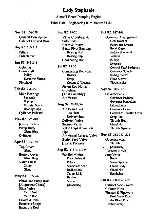

You may find this of use, john - it's an index I made to all the Lady Stephanie construction articles.

Thank you Bob, yes I will look them up. It seems as good an order of operations as any as well.
I'm still gathering materials. I'd like to do as much as I can in brass.
