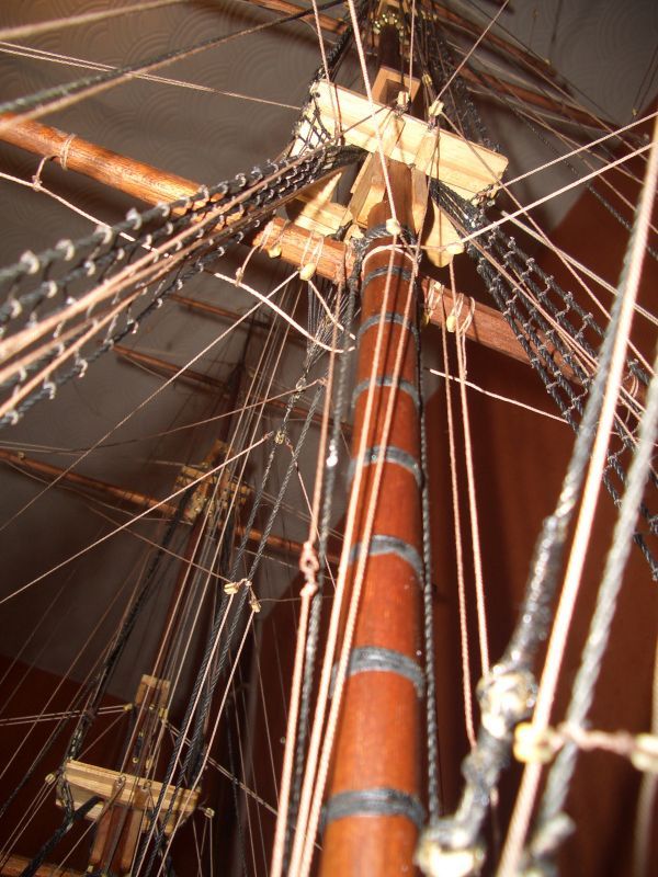

If you are building a ship model why do you need to make brass washers? Wooden blocks work perfectly well.1375814085_1932_ft4006_cimg2927_.jpg

But surely on a model the blocks don't actually need to work? They just need to look right.

Wolfram zu Mondfeld in his book "Historic Ship Models" shows how to make blocks from wood, boxwood is a good material. It doesn't crumble. But I have to confess that I didn't make the blocks in my model shown above, I bought them.
