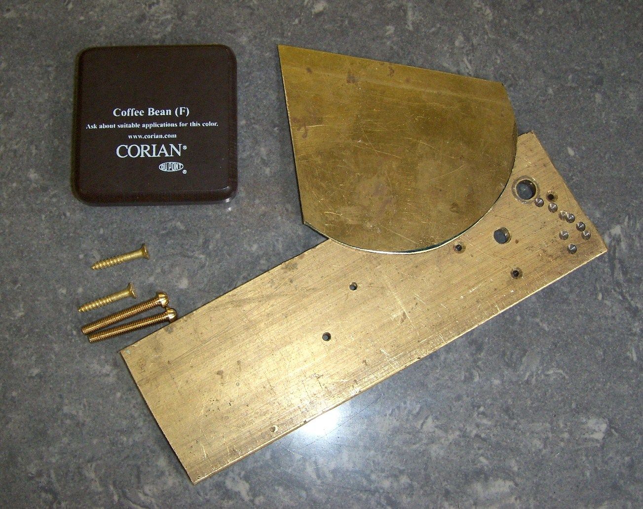

Does anybody have a UK source for a small single pole knife switch? The older looking the better and about 40-50mm long. A double pole would do if it could be butchered.
There seem to be quite a few available in the US which I may end up going for or making my own.
Its for the Hit and Miss engine that I'm working on at the moment which had the knife switch on teh outside of the wooden battery box so something modern won't look right. 6 volts max.
Thanks, J

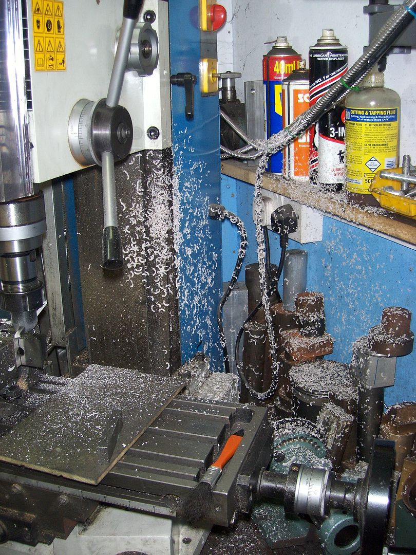

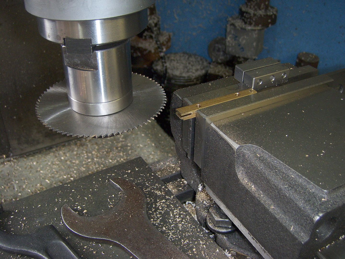

You will all have to wait if you want a full write up but here are a few highlights.
Flycutting Corian gives a very nice finish
Mill a couple of pockets and drill a few holes
Press in some knurled inserts
Mill a couple of brass block and add a slot
Twist up a bit of brass sheet
Bang in a rivit
Job done
Just got to screw it to the side of this, Coke can for scale
Once again thanks for the help and suggestions, J

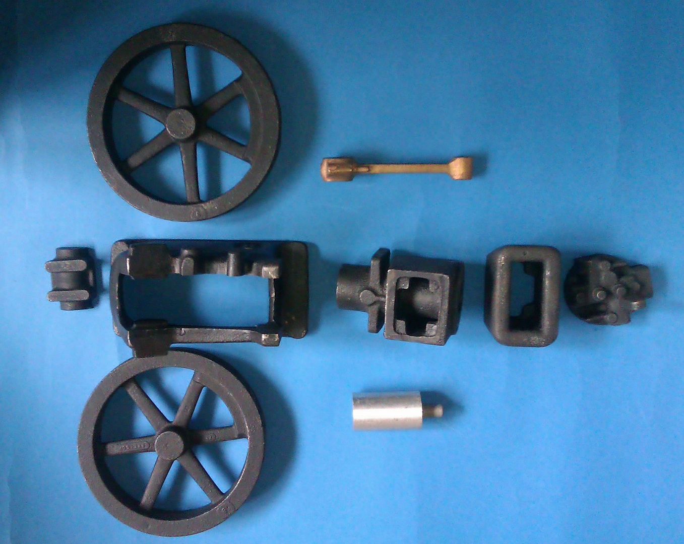

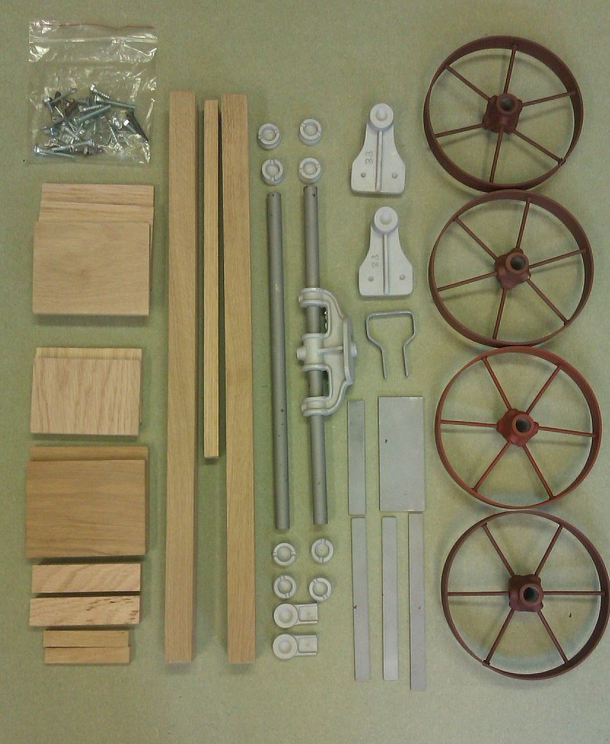

Martin, thats a 1/2 scale model of a 1 1/2 HP Gade, an American engine. Bit different to most as it has two exhaust outlets, one at the bottom of the cylinder which you can see the silencer on and the other in the usual place on teh head.
Unlike my Galloway cart that I had to fabricate this one came as a very comprehensive kit and the guys producing it took all their measurements from an original cart.
I do have a set of castings for the watercooled Amanco Hired Man, there is an aircooled version about but they are hard to find.
