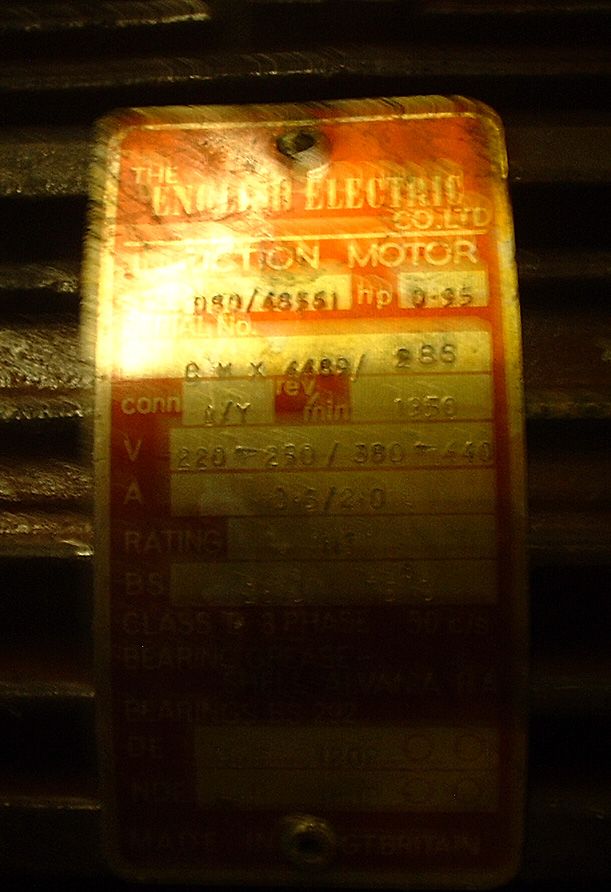

I have taken the motor off the mill and it appears to be dual voltage. i.e. it states 220v / 440v on the stamped plate.
What I dont know is how to wire it (if possible) to accept a VFD 3 phase 240v?
Is it by re-wiring the drum switch?
I have read about STAR and Delta mode but this is where I cannot work out what to do with this motor, if indeed these modes apply to this kind of motor.

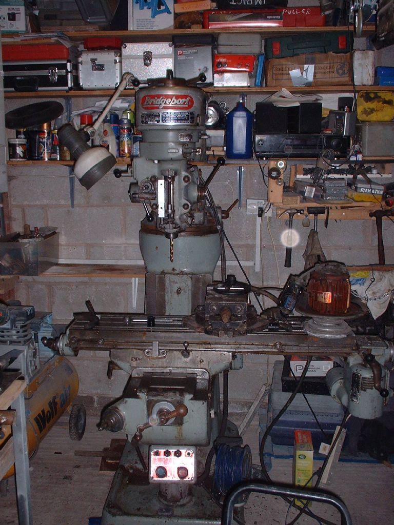

  1. The first photo is mill

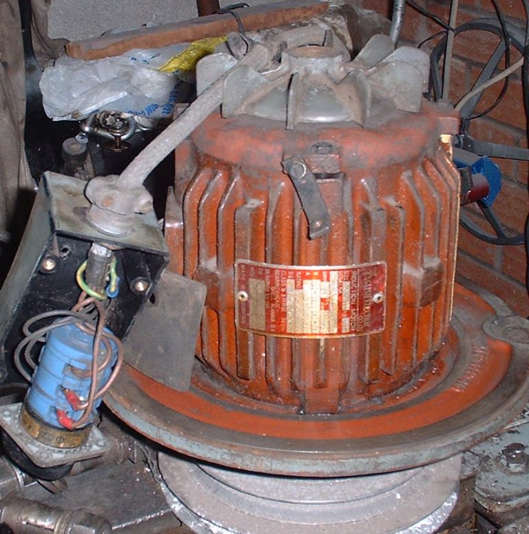

  2. The second is the motor with drum switch connected

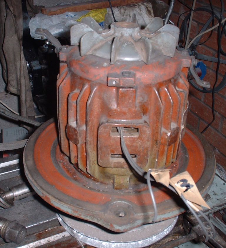

  3. The third is motor with switch disconnected showing the 3 wires coming out - no terminal box?
  4. The fourth is the best shot I could get of the rating plate on side of motor showing what I understand is its dual voltage capability.

I would be inclined towards a dual stage inverter with a 415v 3 phase output as the machine has a auto feed on the x axis, do not know if it also has a coolant pump but if it has then with this option they will all work rather than just the main motor if you opt for 220v 3 phase. There is a cost implication but off set by not having to mess about with the auto feed. You will really miss auto feed, I can not think what I would do without it on my mill as I use it 99% of the time.

The coolant pump on my Bridgeport is three phase, as they are on all my other industrial machines. The table feed is a brushed DC motor, the controller running from 110V derived from a transformer across two phases.

From the pictures of your motor it looks like there are only 3 wires comming out of it so it may have been rewound at sometime. If this is the case it makes configuring it for 230 volts more difficult. You would have to dismantle the motor and find the ends of the 3 windings to allow it to be connected in delta. I have seen reports of people running the coolant pump from single phase by using a suitable value capacitor to provide phase shift. I have not tried this myself. For the feed motor 110 volts supply you should be able to find a suitable 230 to 110 volt transformer. (There might even be a 230 volt tap on the primary of the existing transformer.)
