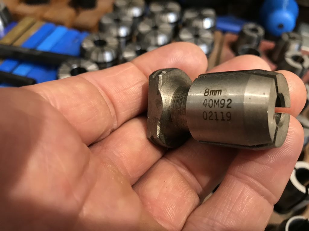

Terry Chandler05/08/2021 11:01:46
21 forum posts
23 photos
Rare but occasionally you find one...8mm Collet
old mart05/08/2021 19:33:32
4655 forum posts
304 photos
Hopefully, the cutters you have will have their sizes marked on them. The metric ones require the metric collets and the inch/fraction ones, the inch size collets. The same rule applies to the Osborn Titanic type of collets.
