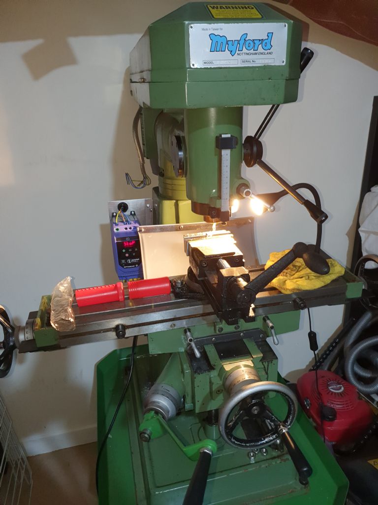

So after some extra expense and hassle I have tonight finally 'made some chips'.
Bought a Vertex VK4 mill vice. Smaller than I expected but DOH my VM-30 at work actually has a VK5 fitted though I mistakenly thought that it was a '4'. Still will do fine I think.
Work light from Ikea. Will get me started but really need something better.
VFD is an Invertek unit 1.5kW, I have used their 18.5kW drives at work so was happy to pay a bit more for this brand. Need to make a remote switch box, running from the front panel for now. Initially it was tripping my house sockets RCD but after unscrewing the 'filter contact screw' on the side this is resolved.
Some quick and cheap spraying of a few bits (mainly the rusty suds pan) using Halfords 'Garden Green' enamel spray paint and the grey spray primer as well.
2 new drive belts but only using the new front one as the rear belt quoted in the manual is too wide??? Hmmmm...
Some new revolving handles for the handwneels from eBay cheap but fine.
Made a new rubber cover sheet for the Y leadscrew using the original stainless profiles and a grey silicone rubber dog bowl mat from Amazon
Fair bit of cleaning and application of 3 in 1 oil.
Wouldn't have got this sorted except for my new 2 tonne SGS engine crane. Huge but a lifesaver.Also excellent service and straps/shackles from SafetyLiftingGear.com their 2 tonne stainless shackles are so lovely I could weep.

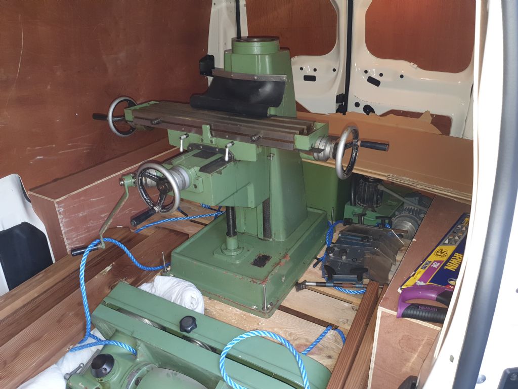

07/10/2020 09:22:54
Again thanks for even more info above.
Got it home late last night. Base: I stood inside it and held it by diagonal corners and walked it to my shed. heavy but managed not too bad. Head: motor already off, lifted it and just managed to carry it to my shed. Quite heavy!
Column with knee and table still attached. I didn't want to split the knee off but OMG this lot IS heavy. I had bolted it to a 120cm by 80cm pallet using lengths of M8 stainless studding and washers. The Vauxhall van I hired from Arnold had perfect tie down loops over the back axle so nothing moved even through the first 10 miles or winding farm roads.
8pm and dark. My mate from next door came over to help. The pallet slid with great difficulty to the back door of the van. I had 6 offcuts of decking that I had just used to refloor my new shed. Made a ramp with these lying on the van rear bumper. With much grunting and cursing we slid the pallet down the ramp then onto cardboard sheets. Then used brute force and planks as levers to slide the pallet into the front of the garage. Sprayed all metal bits with WD then locked up and crashed out.
Gonna buy: another engine crane, more lifting straps and shackles, buy/make a dolly with castors etc. so I can get this built up, but all in good time no rush.

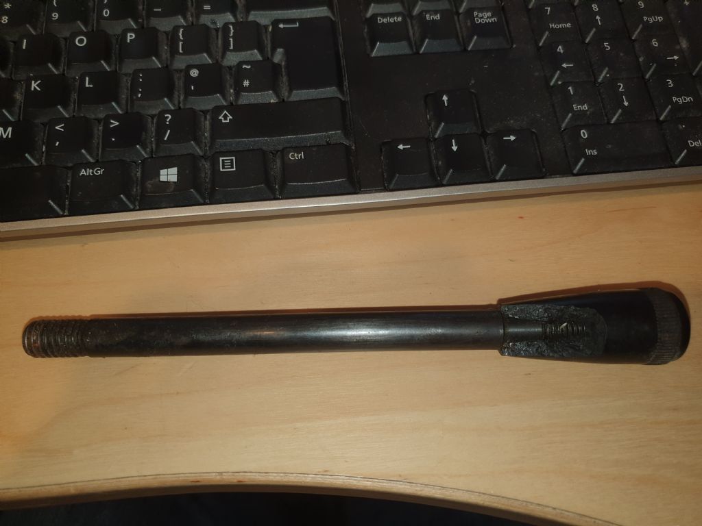

Anyone suggest a source of a missing quill handle/broken knob at the end etc?
