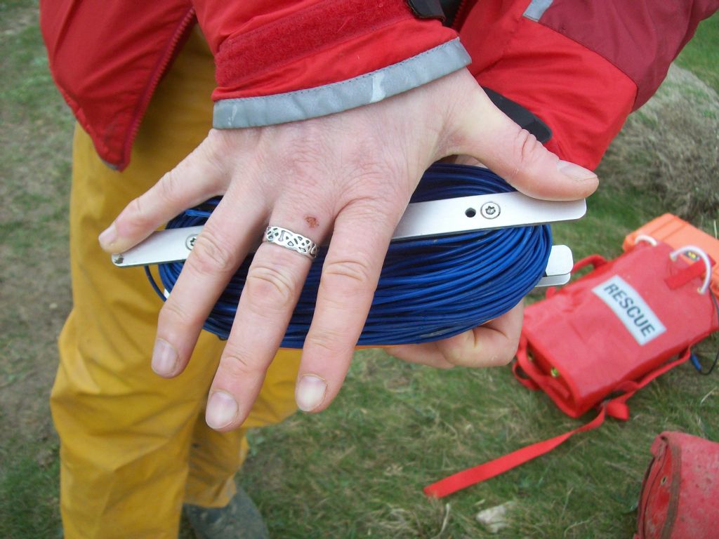

Very prompt service from Metals4U: a batch of aluminium extrusions I ordered on Monday, arrived this afternoon.
This as I've somehow volunteered to make 16 "Heyphone" ariel reels for the Mendip Cave Rescue. Each reel consists of two strips held apart by two cylindrical spacers, a bit like those seaside crab-bothering line reels.
16-off reels so 32 each side-bars and spacers...
Then started setting up the workshop for the batch work.
= Depth-stop on the ML7 spindle, for facing and centre-drilling the spacers.
= Drilling-vice on the Progress bench-drill for depth-drilling the spacers then threading them, using a tapping-head for the spacers. Why not drill to depth on the lathe? Using the bench-drill is easier and quicker. I may replace the vice with a 3-jaw chuck on a base-plate.
= Fence with end-stop on the milling-machine table for making the bars - though I may use the smaller Meddings bench drill for their screw-holes, after drilling the first on the mill to use as a setting-gauge.
The photo below is my "drawing" and Estelle says her hand-span there is 7 inches, so for the racehorse breeders among you, 1-3/4 Hand long. I took the picture at the end of a cave-rescue practice I'd attended, on the surface only, as ex-officio observer and photographer.
The 'Heyphone' is somewhere between Ultra Low Frequency radio and induction-telephone, capable of two-way communication through a significant depth of rock between two ariels that are just long wire dipoles laid along the ground or cave floor between earth-plates, with the instrument connected at mid-point. The electronics live in a dedicated "Pelicase" - a rugged, waterproof plastic carrying-box. The ariels on their reels fit in a small kit-bag.

re above: cited a photo but didn't attach it!

Otherwise, completed the first-off of the ariel reels as in the photo above. It is for "Inspection Department" approval prior to making the rest of the 16 they need, and partly to assess my workshop arrangements and methods for the task.
Examining the photograph closely reveals the reel has two sections, the lower much narrower than the upper, but I'm assured that's not necessary.
