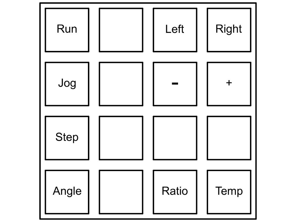

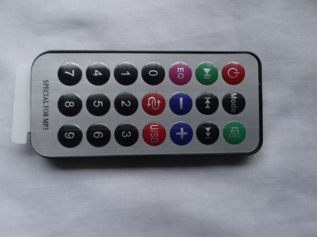

SillyOldDuffer21/02/2017 16:00:53
10668 forum posts
2415 photos
I rather agree with JS on the subject of nested menus. They're a way of controlling a lot of functions with a few buttons, and that can be confusing, or even completely opaque. I have equipment where it's impossible to access the deeper functions without a manual.
Gary Liming's Rotary Table menu system is fairly clear, but I think I could improve on it if there's sufficient interest. I can suggest three ways input might be simplified, without changing the display, or requiring too much new hardware.
One, with a 4x4 keypad, thus:
Cheap waterproof keyboards are readily available; the main problem would be applying the labels. Anyone know how to print on plastic or rubber sheet to make an overlay?
Two, with a rotary digital encoder and a panel mounted joystick. The mode would be dialled up by turning the Mode switch. Then up, down, right, left and 'go' would be selected by moving and pressing the joystick. Labelling is easy and the switches could be protected inside a box.
Three, with a Remote Control like this one:
I'm not happy with the remote method: it's expensive, has excess buttons, I would lose the stupid thing, and I don't like the idea of controlling machinery with with a remote that might get sat on!
Before I go mad hacking Gary's code, does anyone have an interest in having another interface? If so, is there a preferred solution? I don't have an example of a real one to copy and my ideas about the ergonomics of rotary table control are entirely amateur.
