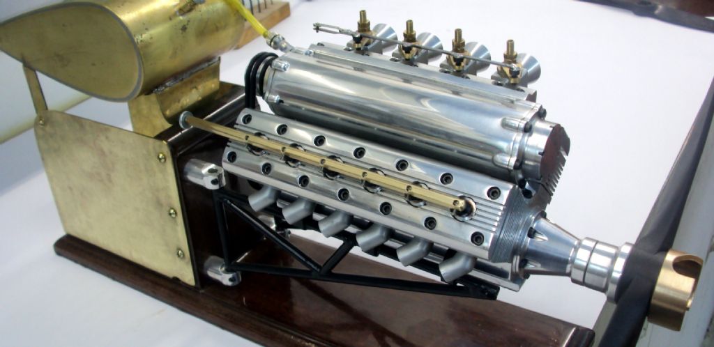

To ask a stupid question, how do you plumb four carburretors to feed six cylinders per bank?
On naturally aspirated four strokes, two carbs give equal induction pulse intervals, but often three are used.
So are all four outside the blower, feeding mixture into a common gallery to it?
Howard
dean clarke 214/12/2015 18:06:11
avatar
169 forum posts
330 photos
All four carbs feed mixture into the intake off the blower, then all six crankcase cavities are feed directly from the blower exhaust through six separate ports. each pair of cylinders in the v configuration is running in a sealed off crankcase cavity with the conrods running on a single big end journal. This gives 5 main center bearings and 6 big end journals. As the blower is one single unit there is an evening out of the mixture internally and therefore an even distribution of mixture to the cylinders.
Hope this explains it clearly?

SUCCESS AT LAST ,,,,,,,,,,, Finally I have been able to get all the pistons lapped in to the liners and ready to run so to speak YAY what a saga that was but all dun now and it's onto the glow plug inserts/combustion chambers, photos below show progress to date
here's the glow inserts/combustion chambers....
Cheers for now
Dean

Well, having been able to spend a couple more nights in the shed this week I have been able to complete the next stage of the engine build. Tonight saw the completion of the glow inserts/combustion chambers and the final assembly of the cylinder heads. I have also been able to modify the fuel rail and freed up the throttle linkage movement. Photos below show the progress to date............................
Last photo below is the front view of the engine so far, all that remains to be done is the 4 fuel needles and the ignition rail. I think it will then be time to breathe life into the beast (hopefully)
Cheers for now
Dean
Edited By dean clarke 2 on 23/12/2015 08:40:12

WELL.......... We're getting closer to life. I have now been able to make and fit the two ignition rails and also the four needles. The engine is off the assembly stand and refitted to the running mount, fuel line is all hooked up and I am now just charging up the power unit for the glow plug ignition system and mixing up the fuel. Here are a few more photos of progress to date........
Photo below shows us all ready to go with the new dog clutch starter mechanism
Well I'm off to mix some fuel up, see you in a while......
Cheers for now
Dean

Well that didn't quite go as I had planned........ the first attempt to bring the beast to life has ended in failure!!!!
Bugger! there isn't enough grunt in the power supply to light up the glow plugs!!, Now where have I heard that before..... (grumble, groan, quietly swearing) worse than that though is when I removed the glow plugs to check things I found they were all dry as a bone!!!! that means no sucking in of the fuel and transferring to the combustion chamber........ double bugger and more groans and grumbles (and a bit louder swearing!)
Ok so why is it not transferring? Simple answer.... no pressure in the crankcase.........no pressure in the crankcase equals no pumping from the blower...... Umm how can that be ? it worked well when I tested it!!!!! Hopefully the simple answer is that the vanes have become gummed up in the slots and the starter simply isn't spinning the engine over fast enough. When I first tested the blower there was no other engine components fitted and the turnover speed was very high with the starter and the blower was freshly assembled and could be heard very clearly working. A good friend of mine has suggested the addition of a leaf spring arrangement behind the vanes to keep them in contact with the case.... I may have to follow this idea up if I can't get it to work otherwise.,, Blast!!! More work!!! Oh well I guess if it was easy then everyone would be doing it right??? Oh yea and the other little bug in the system was a slight fuel leak at the fuel rail from a split hose, funny how these things always wait until the last moment to show themselves, just to let you know they aren't going to make it easy!! So its off to the decompression chamber for me ( a few bourbons should do the trick quite nicely I think)
and then I may look at trying to resolve some of the tribulation issues with giving this engine life...IGOR YOU FOOL WHERE IS THAT EXTRA POWER!!!!!!!!!
Cheers for now
Dean

Did you prime the cyls a bit thru the venturis Dean? You do need a good glow on the plugs of course but you may also need a little raw fuel right down the pipes to get it primed to run, at least at first.
Looks great by the way, well done. Good luck with first startup. JD
Danny M2Z31/12/2015 05:27:24
avatar
963 forum posts
2 photos
Dean, you are nearly there, just teething probs.
As you appear to have each bank of glow-plugs in parallel, the whole 12 at 1.5V would require about 36A from your power supply (about 54W). More if flooded
An adjustable (voltage regulated to 1.5V tweakable) supply that can handle that sort of current may be required. As the plugs are in two banks, twin power supplies rated to about 30A each @1.5V may be the go, one to each rail.
As for the blower, how is it lubed? Light leaf springs could be the answer but once its up to speed probably redundant and just extra wear.
What about a metered (miniscule) prime through each plug hole just to get the blower up to speed.

IT LIVES YESSSS!!!!!! Well it has finally breathed its first breath of life yay.......... still a bit of work required in the fine adjustments and finishing touches etc but the beast lives.....
here is the youtube link to the first run video
dean clarke 207/01/2016 04:04:48
avatar
169 forum posts
330 photos
So its a big thankyou to all of you who encouraged me and also to those few who told me it couldn't be done. Nothing fires up the determination more than being told it won't work or can't be done. While I admit there is still a lot of work to be done in the fine tuning department and no doubt a few more modifications to a few things to deliver peak performance, but there is now no doubt that you can in fact supercharge a 2 stroke engine. For those keen or mad enough to keep following my complete breakdown of all sane thinking the next project is a follow on development of the theory used in this v12 engine only slightly different. The next project is a twin blown w 24 glow 2 stroke.
