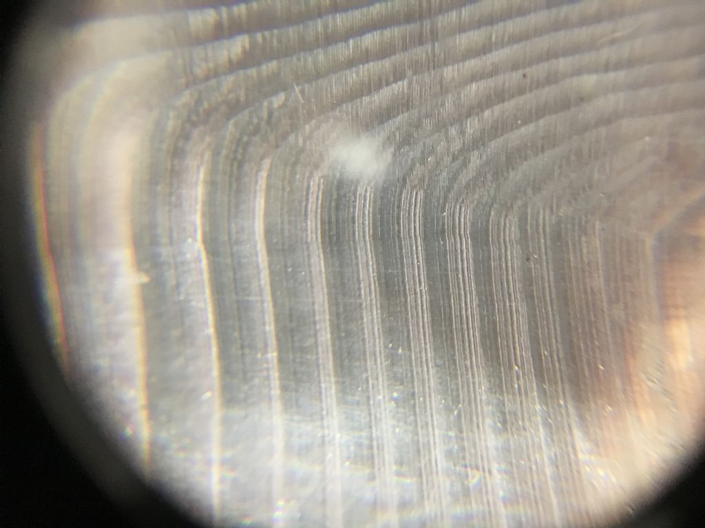

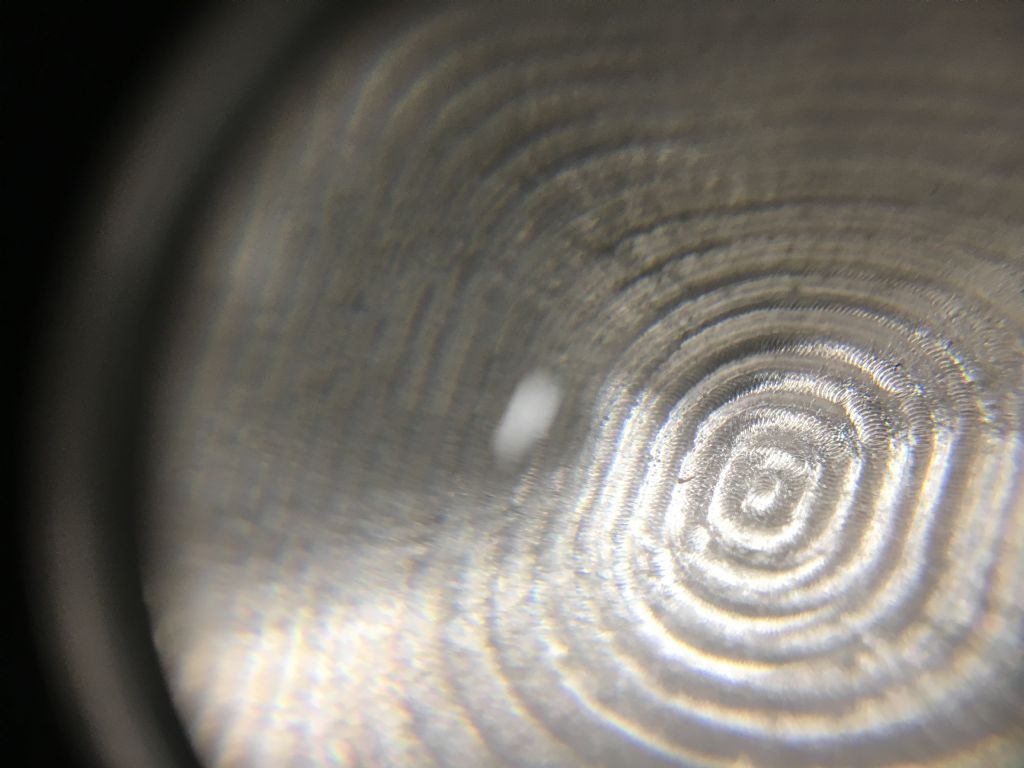

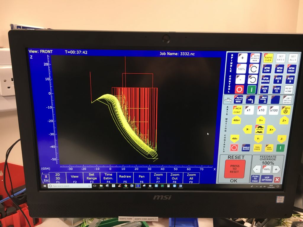

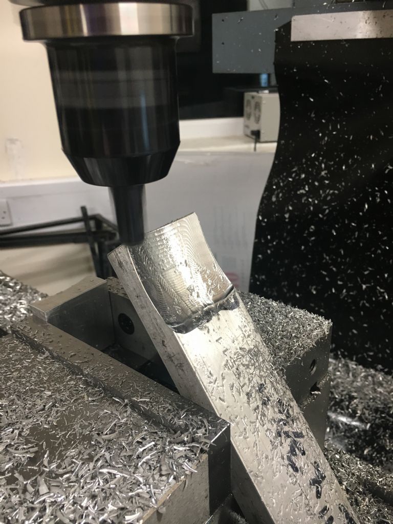

Recently I removed the Chinese 4 axis Fanuc clone controller from my CNC milling machine. It's clearly a very powerful and capable controller but despite my many years working in China and with Chinese, I simply can't fathom the strong Chinglish in the manual and of course any attempts at technical support suffer from the same issue. Instead I fitted a Centroid Acorn controller from the US. Cost twice as much but has the benefit of documentation and support that I can actually understand. And unlike LinuxCNC it doesn't require a PhD in Linux and funny handshakes to set up.
I've now got my Renishaw touch probe, automatic tool setter and rigid tapping working after a bit of effort and support. Works pretty nicely and wasn't too painful to install and configure. Unlike some of the CNC controller outfits, they have been fitting controls to industrial machines for 20 odd years, so by and large they seem to be able to work with most configurations. I bought mine from a Danish reseller, thus avoiding import tax and duty (being in the EU: perhaps there's a lesson there somewhere).

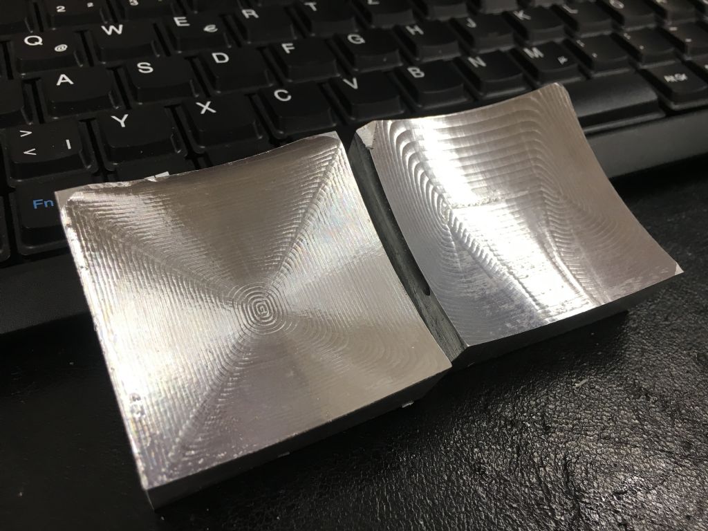

Tonight I machined 2 test pieces. Both the same simple shape - 50mm square stock with a spherical concave surface on the top face. You generally machine these with a ball ended end mill but the disadvantage of these cutters is that the surface speed of the centre of the tool is zero and you end up with scuffing and a poor finish where that part of the cutter is used. The approved solution is to use a 5 axis machine so that you can tilt the tool towards or away from the direction of travel. That's not an option for me, as the present Domestic Manager won't stretch to that. Instead I thought I'd achieve a similar effect by tilting the stock at 55 degrees to the vertical, so that the end of the cutter never has to attempt any cutting.
The toolpaths are quite easy to do in Fusion 360. To achieve the tilt you simply define the Z axis at the required orientation and within reason, the rest follows.
Sure enough, the surface finish is a lot better, although there would be further improvement if I used a tool with a better (polished) edge - you can see the grind marks from the tool on the workpiece. And coolant would have washed the swarf away and prevented any minor recutting. I don't have the guards back on yet, so coolant wasn't a sensible option.
Side by side
All in all, an interesting result. For surfaces that would benefit from a fine finish, this approach has potential. Obviously set up takes a little longer and the machining time was about 50% longer but each piece took under 30 minutes, so hardly an issue.
Conventional (perpendicular) toolpath. Look carefully and you can see the spiral surface finish in the middle of each track:
Ball end E/M surface finish
With angled tool. Every imperfection on the ground edge of the tool shows up!
Angled ball end surface finish
Murray

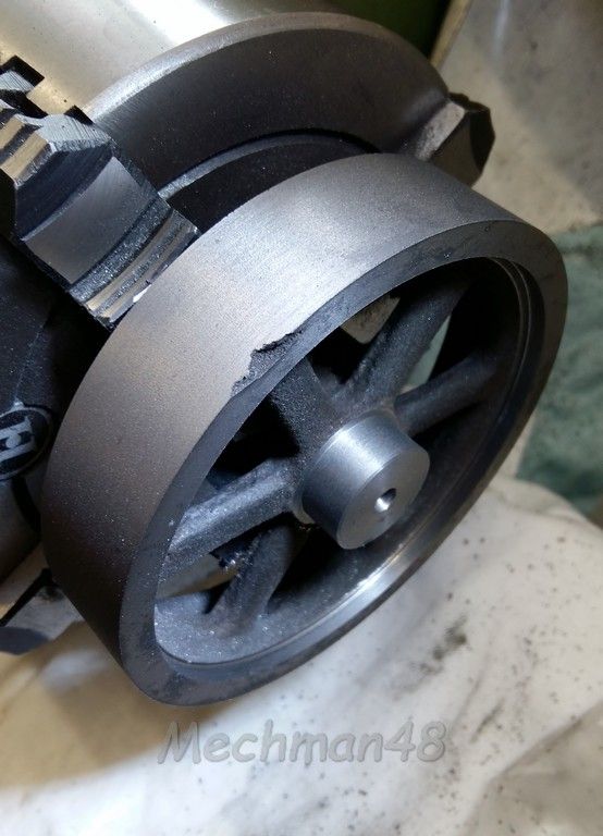

Started on the flywheel for my Vertical cross; casting was a bit rough looking at the start, ( unfortunately didn't get a pic before starting ),I have another casting but that's even worse, anyhow by the time I got through a section of chilled casting, what started out as a 4" casting ended up as 96mm OD, & still had remnants of a blow hole on the rim. The only option was to mix up some two part epoxy resin & blend in some CI filing dust to strengthen & colour match...
Apologies for the out of focus shot, but you can just make out the hard spots on the centre line......
Remains of the blow hole imperfection...
Mix of 2 part epoxy & CI filing dust applied ....
​Should blend in fairly easily...
George.
