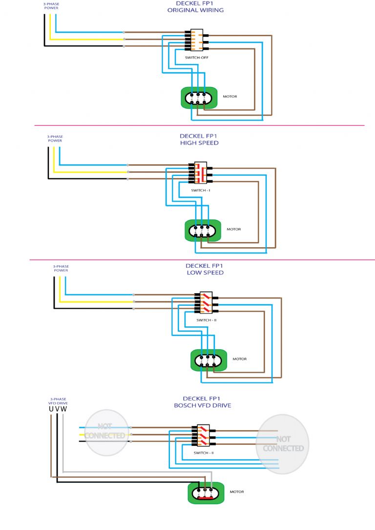

My motor, which is the original motor fitted, is marked Siemans-Shuckert , 380V, 2.7/2.8 A, 0.8/1.1kW, cos ó 0.64/0.8, 700/1420 U/min
There is a switch to switch it from low speed to high speed. This switches it from Star to delta ( or Delta to Star - I will have to check)
It is running satisfactorily on VFD with 230V and 29Hz.
I notice that the motor draws almost the same current in low or high speed ( 2.7 or 2.8 A ) and the power rated is 0.8 or 1.1 kW.

Posted by Gerard O'Toole on 14/01/2020 13:06:17:
It may be switching from star to delta, but is also pole switching from 4 to 8. The key is the last part of the plate:
700/1420 U/min
In other words 700 and 1420 rpm in low and high speed respectively.

Hello Gerard from the information you recently posted it would suggest your motor is a two speed one, with POLE changing switching to give the two speeds,and NOT Star/ Delta. John

Gerard says: 'There is a switch to switch it from low speed to high speed. This switches it from Star to delta ( or Delta to Star - I will have to check)' Normally changing from star to delta wouldn't alter a motor's synchronous speed. Isn't it likely Gerard has a switched pole motor like a Dahlander?

Gerard O'Toole14/01/2020 17:57:14
159 forum posts
13 photos
The Dahlander diagram may be correct. The description I have, translated from the German, is "pole-reversible motor 700/1400 revolutions" - even though the plate clearly shows 700/1420 U/min
i am only using it in the low speed (Delta) configuration .And as I have the base frequency set to 30Hz , I am not even getting the maximum of the low speeds.
What would happen if i switched to the high speed(double star ) connection? Would i achieve higher speed or would I damage the motor?
Sorry , I just realised that I can not connect the neutral so unlikely to be possible.

Gerard O'Toole14/01/2020 18:33:44
159 forum posts
13 photos
When the VFD was fitted, I traced the wiring on the switch deckelwiring2.jpg and the wiring in the motor motor wiring.jpg
Andrew Johnston14/01/2020 20:11:05
avatar
7061 forum posts
719 photos
Mark: Thanks for the explanation.
Gerald: It should run fine in star. If you look at your diagram in high speed mode wires 4, 5 and 6 are connected together, but they don't go anywhere. You don't need a neutral line to run a motor in star. In theory the current in a neutral wire would be zero.

Gerard O'Toole14/01/2020 20:30:36
159 forum posts
13 photos
Posted by Andrew Johnston on 14/01/2020 20:11:05:
Andrew
Thanks Andrew. really good to know. I will set up the tachometer and try to see what speeds the motor produces.

Gerard O'Toole16/01/2020 16:33:53
159 forum posts
13 photos
  I eventually fitted the digital tachometer and measured the speeds on the mill in comparison to the speeds given on the gearbox plate for low and high speed . The VFD was set with voltage set at 230V and base frequency at 31.5Hz
Low Speed High Speed measured Speed
95                    190                       128
150                  300                       205
235                  475                       322
375                  750                       389
600                1200                       637
950                1900                     1040
It would seem that the motor is wired for high speed and is achieving over 50% of the expected speed.

Mike Poole16/01/2020 20:16:24
avatar
3676 forum posts
82 photos
I am wondering if you are muddling the base frequency which should be a motor parameter with the output frequency for the desired speed. Setting the desired output frequency to 50Hz should give the speeds on the plate. The base frequency is information used by the inverter to model the voltage/ frequency curve for the output to the motor.

Gerard O'Toole17/01/2020 09:50:11
159 forum posts
13 photos
Posted by Mike Poole on 16/01/2020 20:16:24:
Mike
It is quite possible I am muddling things up.
The actual settings, On the Bosch Rexroth VFD, refer to max. frequency and upper frequency, both set to 31.5 Hz
(= 50 x 240/380) (it should be 30,3 Hz (= 50 x 230/380). This keeps the voltage/frequency ratio constant which I gather from all the answers here is not really necessary.
