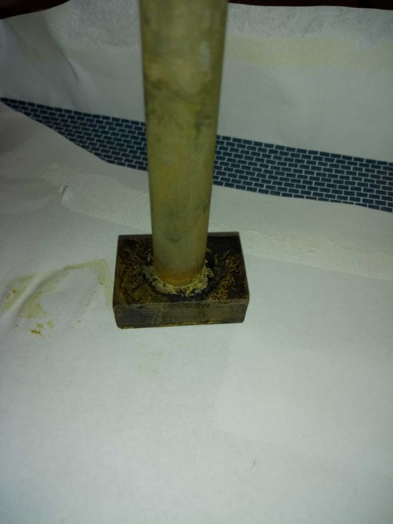

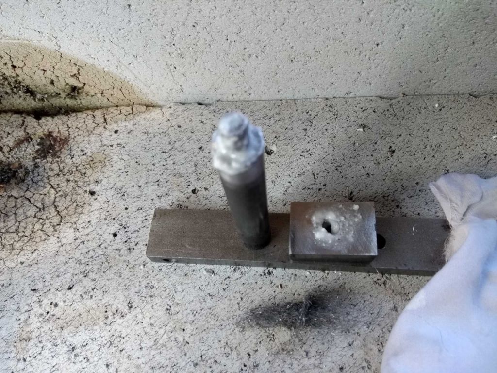

So back to soldering. I followed pretty much all the advice and this time it looks to have worked! I will need a few more goes before being confident, but thumbs up so far. I'm not entirely sure which 'advice' made the difference - or possibly a collection of changes. Still...
Firslty, the rod and block were sanded and wire-wooled and cleaned with meths.
and
I'd thickened the flux up, but I was still expecting something smooth (like the so often described cream), but it remains a powder suspended in water - lots of lumps. Is this right?
I originally bought firebricks (from a domestic fire) but for some reason thought that they were absorbers of heat not reflectors so got these bricks instead. Looks like I was wrong.
This time I'm soldering upside-down (the piece - I stood upright, it's hard enough as it is!).
I'd also turned the regulator up to 7 and got a little more flame which I kept further back. It also seemed to make a nicer cone.
I'd put a little curl of solder in the hollow at the top and at some point (probably about 4 minutes in ) it disappeared - into the join. It was only a little bit so I added some more. I still wasn't able to get the solder to melt just by touching it to the hot metal (which all my books say is right), but with some flame it would melt and I guess capillary in.
I know I said I'd heated it from underneath, but I brought the flame up as well occasionally - the block is the bigger heat sink.

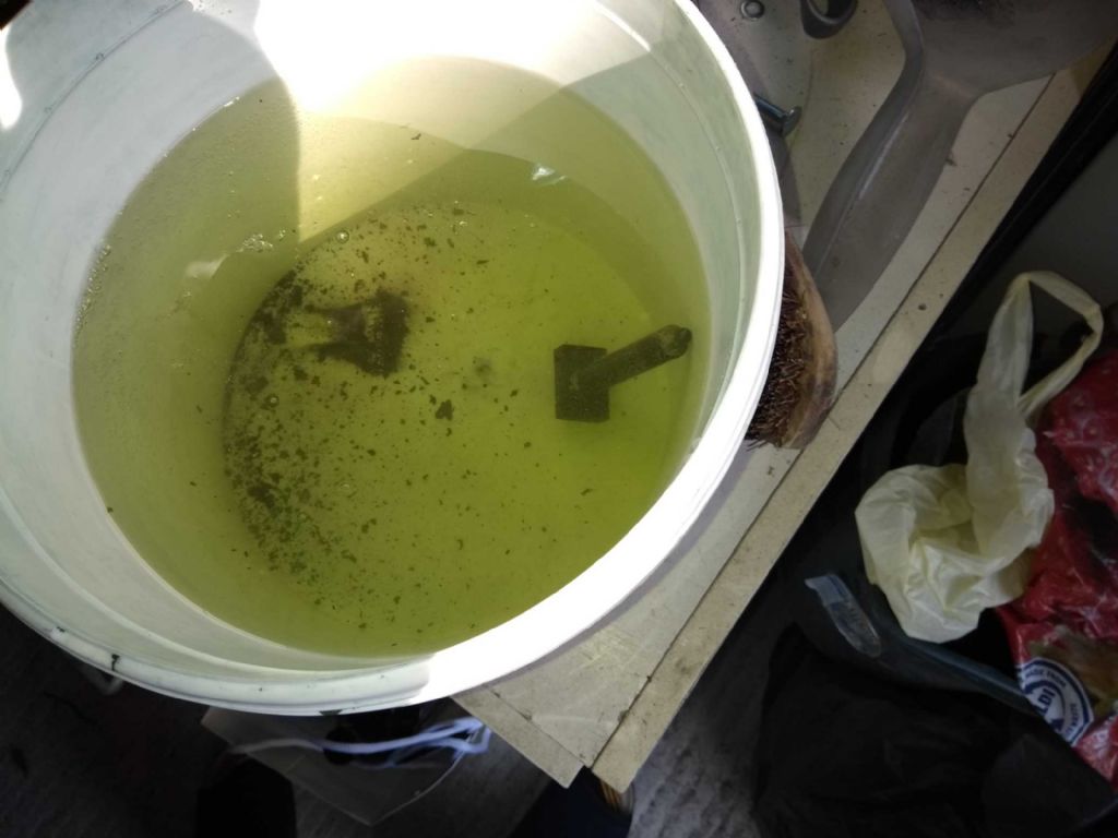

I'd also spread my research wider and found I could 'pickle' the assembly. I'd bought 1kg of citrix acid which I dissolved in about 4 - 5 litres of hot water. I was expecting it to become saturated, but think I need even more.
Her is the piece in the pickle bucket.
It was in the bucket for about 2.5 days before I got bored and took it out and rinsed. The scale has largely gone, but the metal rusted very quickly after being rinsed. Should I have left the pickle on? Should I have left it in for longer? What's a sensible amount of citric acid for a bucket (3.5 litres of water?). Can I filter the nasty bits out or do I need to throw the lot away?

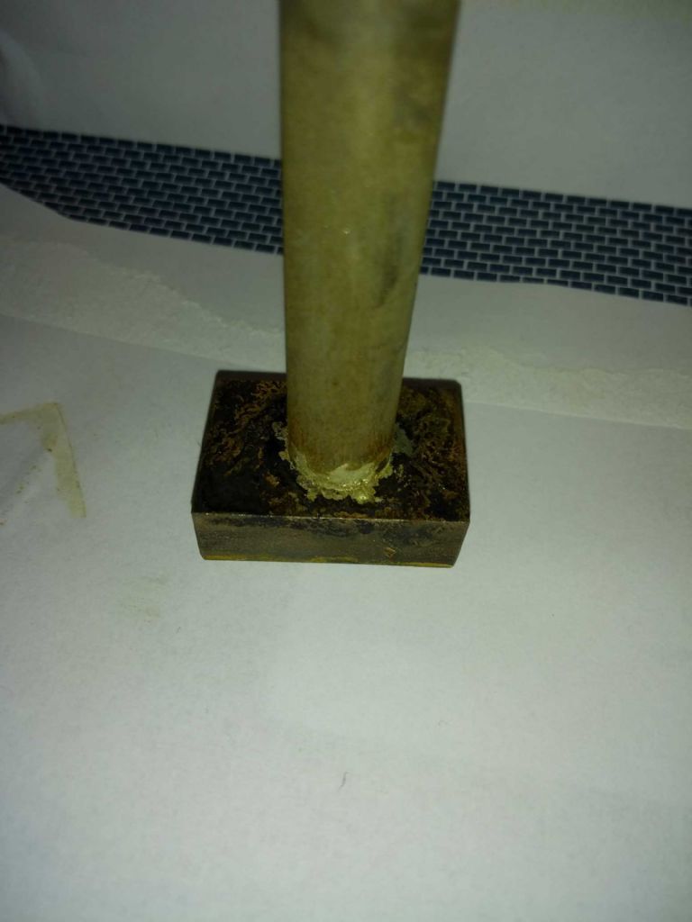

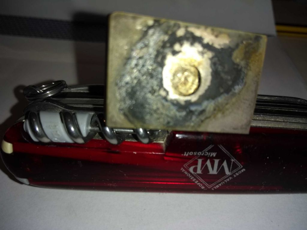

And here we have the results.
Front and back views of the top of the join
and the underneath view of the block.
One of the challenges with coming into this sport is that you don't really know what to expect. For example, I had to heat this assembly for 4 - 5 minutes before the solder ran. I had the impression that this would happen much quicker. And I don't really know at which point the solder should run - what colour should the metal be? And if I want to use Low and High temperature solders to assemble a complex piece, How do I know which colour to aim for aim all cases?
I suppose the practical answer is clear - and I'm already applying the technique - trial and error! Try often enough and instinct starts to work ... sad

SillyOldDuffer24/05/2019 15:02:47
10668 forum posts
2415 photos
Posted by Iain Downs on 24/05/2019 13:42:19:
Iain
Gritty flux rather than Dairy Double Cream is what I get.
Using the wrong firebrick will cause trouble if your torch is on the small side. Insulating firebricks are usually light and soft, absorbing firebricks are heavy and hard. The heavy absorbing type are NOT what you need. Don't guess, get the right type. (Or a much more powerful torch!)
Pickling: Dilute Sulphuric Acid if you can get it is best because it is fast and cheap. Minutes rather than hours. Citric Acid is a lot slower (overnight). How fast scale is removed depends on the concentration: your mix was weak, try for about 1:1 by weight, ie 1kg of Powder to 1 litre of water. Heating the water will allow a higher concentration and speed the pickling reaction up. Once by inspection the acid has cleaned the scale off, mild-steel reacts immediately with air. The trick is to clean the pickle off get soldering the metal as soon as you can. Keep using the acid until it stops cleaning metal or goes off (Citric Acid is biodegradable!) No particular reason to filter it.
I think you're doing the right things, but likely too slowly. How to fail: buy an ordinary DIY blow-lamp with a low heat output. Build a leaky heath out of heat absorbing brick. Then take two hefty lumps of rusty steel, apply a thin watery layer of flux, and poke at the job with a wobbly flame for far too long before applying the solder. The small torch is hot enough to activate the flux, but not powerful enough to get the metal up to temperature quickly, especially if the operator has L Plates. By the time the metal is hot enough to melt solder the flux has failed, scale reforms, and you get a dud joint.
Trial and error teaches you to get everything right quickly, it's experience not instinct. A beginner would probably do better starting with a big torch because getting a small one to do the same job needs more skill. I'm too mean to buy a big torch, and my results are intermittent. I'm much more likely to succeed soldering smallish lumps than big ones, and I believe the reason is the extra time bigger jobs take to get hot.
JasonB24/05/2019 15:50:39
avatar
25215 forum posts
3105 photos
1 articles
If you want to use punch marks then three evenly spaced ones will do the job.
Add as much powder to the water as you can before it won't dissolve any more though it will take a long time with such a mild acid, Brick and patio cleaner will do it in 1/2hr but don't forget you have something in there or it may get eaten. Just let the muck settle and decant the clear stuff, discard the bit in the bottom.
When you take it out of the pickle rinse in water and give a scrub with a small wire brush, dry and spray on a bit of WD40 straight away.
Flux will first bubble to a white throth, then becomes a sticky melted sugar consistency then it will flow as a clear liquid at which point you are upto temperature. I'll photograph a bit of mixed up flux over the weekend for you

SillyOldDuffer24/05/2019 16:55:52
10668 forum posts
2415 photos
I thought all Patio Cleaners were based on Hydrochloric Acid. Apparently times have changed! It now seems most Patio cleaners don't contain acid of any type and - like the Swarfega example - would be useless as a pickle.
The right stuff is still available. Look for Acid Brick, Mortar or Patio Cleaner like this example on Amazon.
Though it's fast acting I'm not entirely happy with Hydrochloric Acid as a pickle though. I've read it leaves chloride ions trapped in the pores of steel that cause rust later. Even under electro-plate or good paint. If used and corrosion is a concern, give the steel an extra thorough cleaning.
By the way, no need to pickle freshly machined steel. It's plenty clean enough to make life easy for the flux. Pickling might even make things worse, especially if the wrong chemical is used.

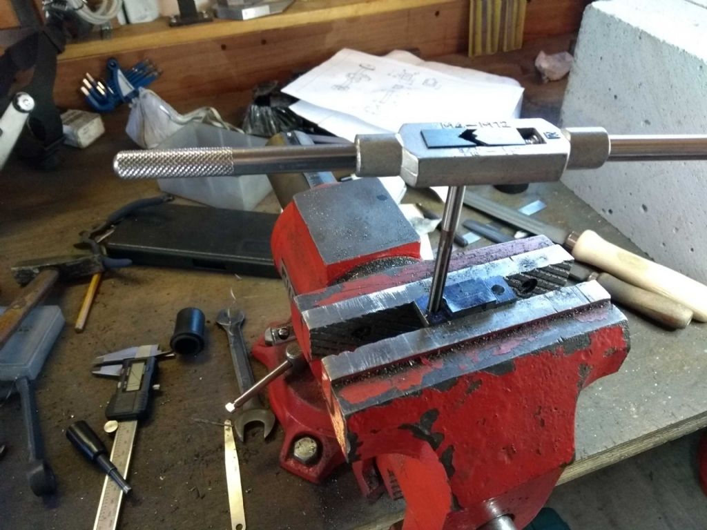

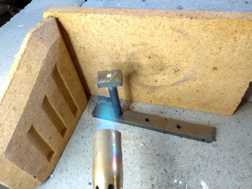

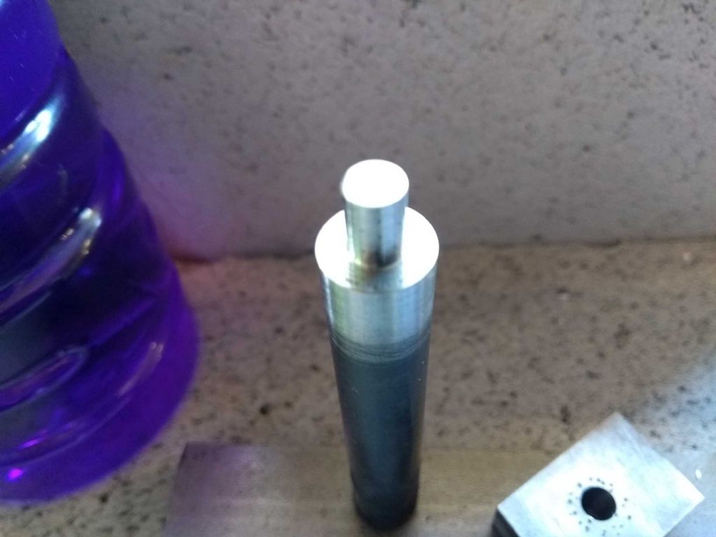

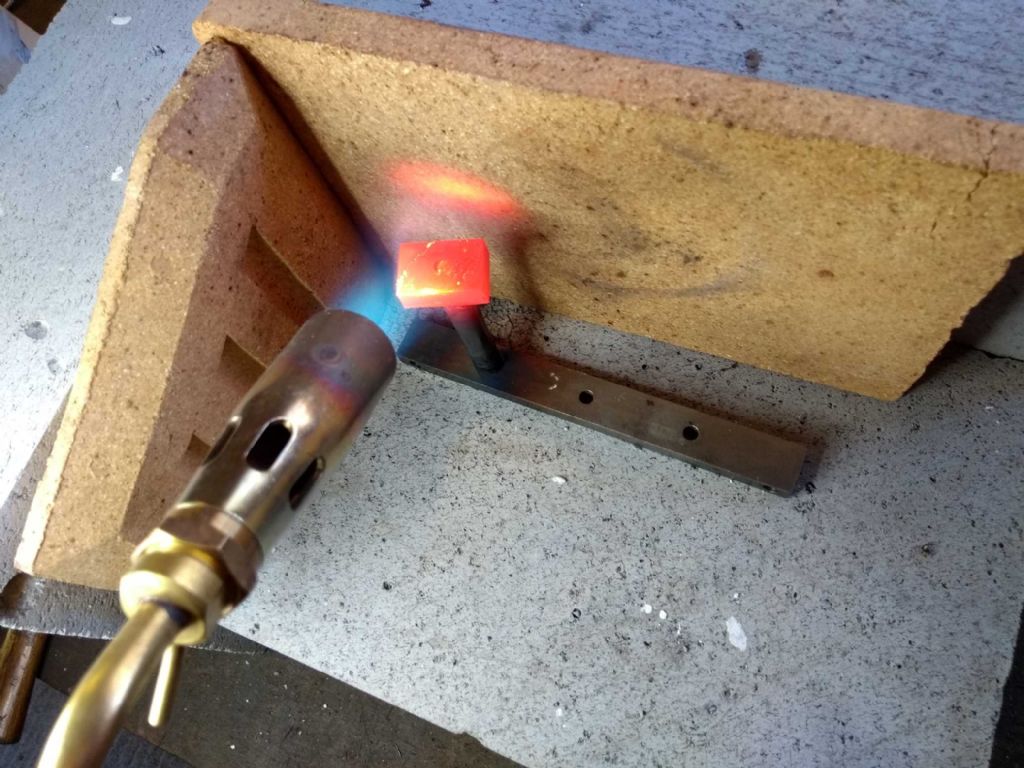

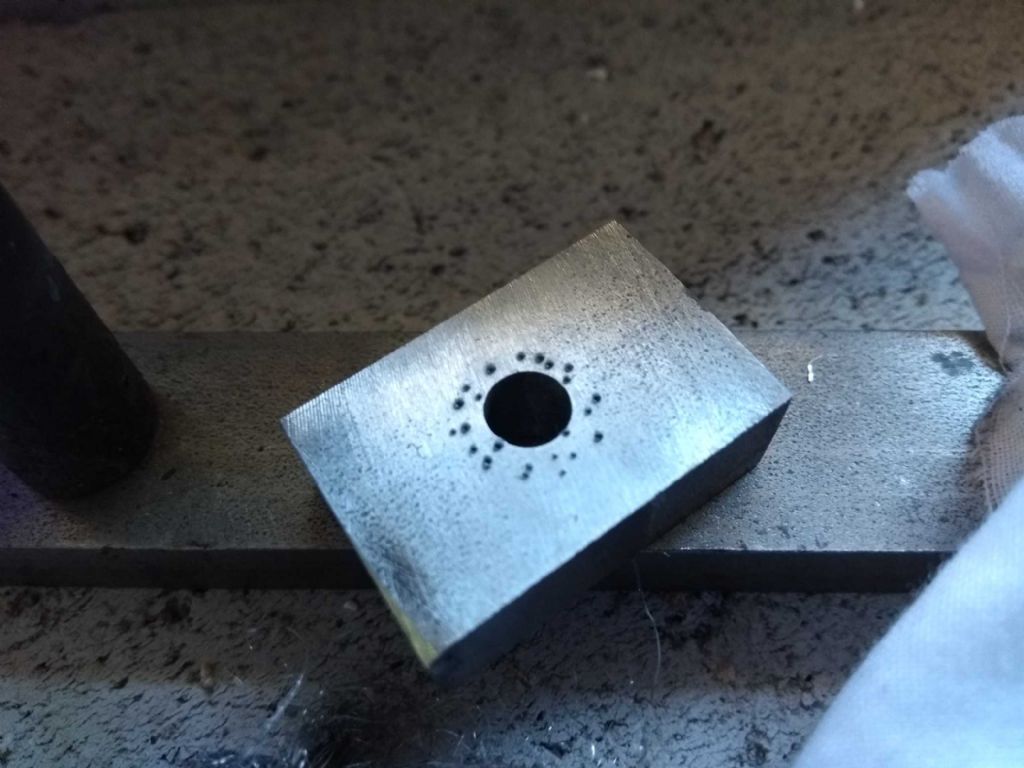

Well as i had mixed up some flux to photograph why stop there!
Piece of unknown steel 36 x 20 x 11 that already had an 8mm hole in it, just sawed it off a bar and cleaned up the flat faces on the belt sander. Piece of unknown 13mm bar turned to fit the hole.
Flux to a thick creamy consistancy (see later video) applied to hole and spigot, no punch marks use on this job. no other cleaning done
Push the two together and make sure there is a good fillet of solder around the job. Raised the work up off the vermiculite blocks which saves the flux sticking to the block and also allows heat under the large lump of steel. Solder won't take to the rusty bits of angle iron which are kept for this type of use.
See video for heating, use dthe same torch and burner as you, my 4bar regulator was fully open. I did use 42% solder you you may need 30secs or so to get upto 55% temps.
taken just after the torch was turned off you can see the flux starting to harden and the clean area of steel where it has flowed can easily be seen through it
After quenching, I don't often quench but a sit was just for a test no need to worry about distortion or hardening unknown metals, extent of solder flow easier to see.
After 20mins in the brick cleaner, the pink tinge is copper from the acid which is a couple of years old, it leaches out when you also use the pickle for copper/bronze and brass but cleans off easily enough.
Finally the proof of the pudding, a nice fillet of solder at the end of the spigot showing good penitration.
Not the best video as it is hard to hold the torch and camera in one hand while waving the solder about in the other. Job is hot enough for solder to flow at 1.36 into the video, a bit cold before that so allowing for the flux shots that is 1min 20secs to get upto heat and a similar volume of steel to yours.

SillyOldDuffer25/05/2019 11:00:25
10668 forum posts
2415 photos
Angle iron to lift the work so the flame can heat underneath as well! Such an obvious good idea : why don't I think of them?

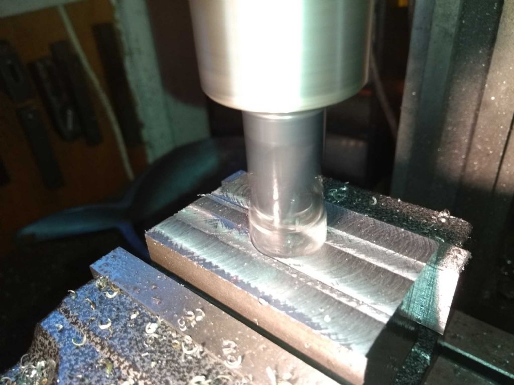

Anyway, I put it all back together and got on with thinning my 40mm to a 30mm. I'm using a 17mm face mill which is at the limit of the spec of the machine (CMD 10 / X1 for those who are new to the thread).
I'm running it at 2000 rpm (top speed as this gives a smoother finish and rattles less. I'm taking off about 0.5mm each pass as here
Things were going so well (thinking new gears, eh!(, that I upped the depth to 1mm, but it did not like this, overloading. So I dropped down to 0.75 mm or so. That worked for a bit, but I saw overloads again,so dropped down to 0.5mm again. And then it broke again.

I'm a little concerned that the face mill is putting too much load on the gear train. I've regularly being taking 1mm and more off off with a 10mm carbide end mill, so I don't *think* it is the face mill which is the root cause - more likely just general wear and tear. Opinions welcome though.
Iain
JasonB25/05/2019 13:12:01
avatar
25215 forum posts
3105 photos
1 articles
Iain, what parentage is the insert that you are using in the cutter?
I bought a 50mm facemill a year or so back and my X3 did not like it one bit with poor finish and lots of really bad vibration shaking teh whole machine. A change to some better quality inserts which cost more than the whole facemill, arbour and 10 inserts solved the problem and it now works well.
Some of the cheap inserts don't have much in the way of a cutting edge which may be OK on a hefty machine that can power its way through but it is just like using a blunt cutter on our lighter machines.
Iain Downs25/05/2019 13:49:14
976 forum posts
805 photos
The facemill came from ARC Eurotrade. Which probably makes it pretty good.
At 0.5mm I get little vibration and a reasonably decent finish. At 1mm I get a bit of vibration and a slightly rougher finish. But the controller keeps cutting out with an overload.
I have more vibration issues at 1000 rpm and I had bigger issues until I turned the (triangular) inserts round and forced them into place.
I think the facemill is OK actually - just that the CMD10 is not the brawniest in the block.
