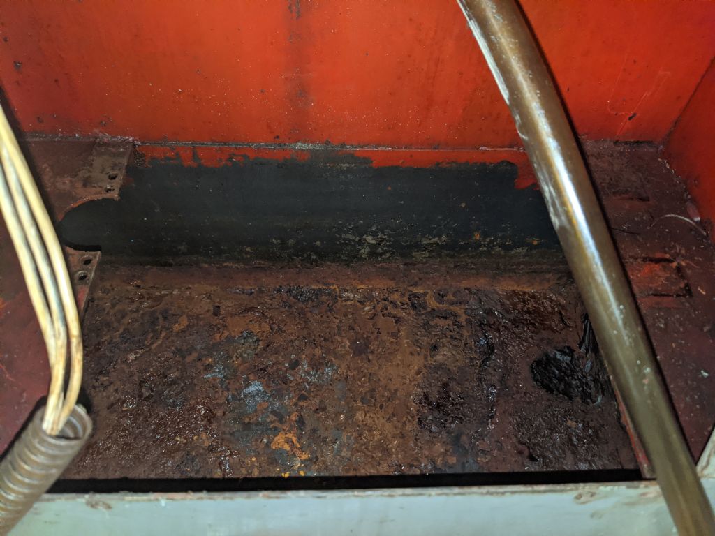

Does anyone know what material the coolant tank is made from, when i cleaned that out there's been a bit of corrosion and some really small places have corroded through. I can borrow a friends MIG welder, and I have some experience welding, so will i be able to just fill the gaps so it's nicely water tight? Recommended or unrecommended?

I, for one, would never recommend welding on any closed vessel that has had hydrocarbons in it previously - unless proper precautions are undertaken beforehand.

I wouldn't call it fully closed, It could be cleaned out fully and could have a hoover in there too for fumes?
However, what precautions or other methods would be suitable?

If using a MIG clean the tank well and then fill it with shield gas to displace vapours and oxygen. Close the filler with a bit of plastic film and an elastic band so any thermally induced pressure increase is vented..

Calm down chaps! all good safety info is worth listening to, but the coolant tank on a Colchester student is actually the centre base of the lathe, and is accessed by opening an 18" square door underneath the chip tray, no way could anything explode, and very unlikely to catch fire! A good soak in hot soapy water is all that is needed. The coolant tank is steel like the rest of the lathes stand.

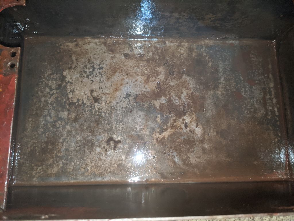

Apologies, I haven't quite described it properly. By tank, i meant more fish tank, so more like an open box rather than a canister with a cap. I forgot to put pictures on.
As Phil says, there's an 18 inch opening for scale for the pictures.
Phil, the tool post is all back together now, and it was a pain to get to pieces, have to take the top slide all to pieces as well just to get to it. I'll see if i can find any similar pictures online and i'll watch those videos. Got some other jobs to do around the house first! Thanks
Before cleaning, about 1cm of gunk and rust and whatever else was down there
After cleaning and oiled. Holes are small, but would still leak.

When repairing similar on my M300. I got a thin sheet cut to just the right size for the base and got a local faricator to weld it to the base for a drink, rather than attempt to repair a very poor surface.

I'll go in and wire brush all the surfaces so they should be clean. It should be less welding for me to just plug the holes than put a sheet in. And I won't need to buy a sheet. The metal looks thick enough already I think

if the holes are small, what about coating with an Epoxy sealant?

Thats not too bad Richard, I think I would just weld up the pits and then clean and dry it out thoroughly with a hot air gun and give it a couple of coats of two pack epoxy paint. The tool post you have is identical to mine, mine was very stiff too, so I stripped it..................it has never worked 100% since, but of course I dont know how well it worked before I got it! they are a pain to reassemble! Funny you should link to the above post from 2014, I actually commented in it!
