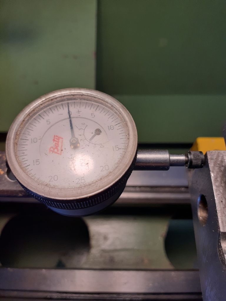

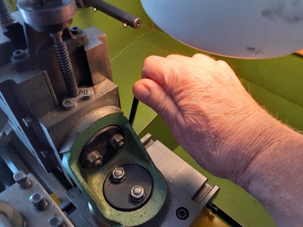

Here's the method I use to set up my vertical slide on the Warco WM250V. It seems quick, simple and reliable to me, and you don't usually have to take off the topslide/toolpost assy.:-
1. Clear lathe
2. fiddle slide into position
3. Butt the vice fixed jaw to the front face of chuck jaws
4. Lightly nip the distal capscrews
5. Tighten the proximal capscrews near...
6. ...and far
7. Check jaws still in contact
8. Check you can mill across full width of vice.
9. Set clock on far edge of vice jaw
10. Wind crossslide to near edge of vice jaw and check clock. Parallel within about a thou.
This just takes me a couple of minutes.

Here's the milling slide for a mini-lathe attached in the same way to my WM250:
and
I did that to attach a milling spindle:
which works well, and can be fitted anywhere along the cross slide. Its main use is for cross drilling holes, PCDs or fluting knobs so it normally lives in a QCTP holder
