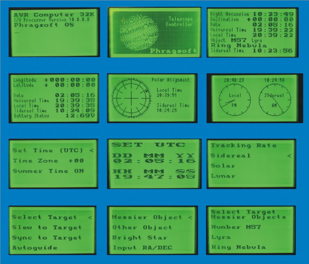

I have redesigned the PCB as instead if a 16x2 alphanumeric display, I will use a 64x128 green graphic display from an old project instead which can display a lot more information, including proper lists of targets.

Here's a pic of my 'splash screen' for now.

Basic box is working now, solved a problem with excess current consumption - one of the Pololu stepper boards was swallowing 65mA extra following every reset. Swapped it out and all three boards only take about 7mA each when doing nothing. Mind you the display is greedy - but the LEDs will be 'turned down' for night use!
Some screen grabs of work so far. Coding for calculating sidereal time to an accuracy of about 3-4 seconds over the whole century and the position of Polaris to half a degree over the same period were challenging in 8-bit assembler.

Michael Gilligan02/05/2016 21:29:15
avatar
23121 forum posts
1360 photos
Impressive work, Neil yes
Just one little negative point, if I may ... It is generally accepted that Red is a better colour for use in a dark environment.

Neil Wyatt02/05/2016 22:03:40
avatar
19226 forum posts
749 photos
86 articles
Posted by Michael Gilligan on 02/05/2016 21:29:15:
Try finding a RED 64 x128 LCD display! Swapping out the LEDs on these waveguide -type displays isn't a trivial exercise.
That said, there is a counter-argument that as the eye is more sensitive to green than any other colour, you can set a green display much dimmer than a red one and a display doesn't have to be very brightly illuminated at all to be readable at night - much dimmer than my red torch. My existing unit uses a 2x16 green LCD and it doesn't cause me any problems.
And having said all that... I have a QVGA full colour display that I might drop in instead, which would do a very good job of red text/lines on a black background. But then I will probably want to add an SD card to display colour pictures of the objects...
Michael Gilligan02/05/2016 22:19:59
avatar
23121 forum posts
1360 photos
Posted by Neil Wyatt on 02/05/2016 22:03:40:
The problem is more to do with Loss [vs. retention] of Dark Adaptation.
But; if dim Green works for you, who am I to argue.
[You may not be popular at a typical 'Star Party' though.]
