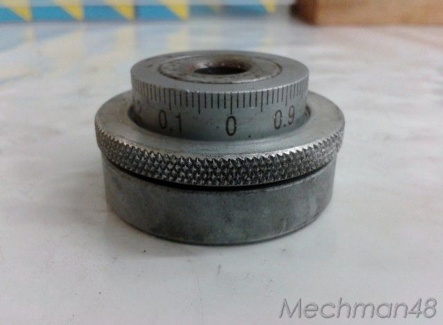

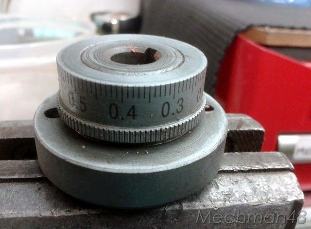

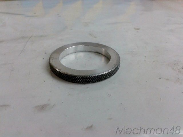

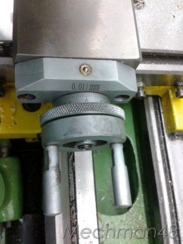

As mentioned in previous post; I made a larger knurled grip to fit over the friction collar on the top slide as I could not get a grip on it to set 'zero' due to 'chubby finger' syndrome. I was going to make it a shrink fit but couldn't quite get the dimensions right for hot water expansion method & had no hotplate in the w/shop so I made it a press fit.
1. Original as supplied with machine:
2.Manufactured new knurled collar
3. Press fitted to handwheel over original collar.
4. Reassembled to top(compound) slide
Obviously the OD can be made to suit your own dimensions but I made this to look cosmetically in keeping with the topslide scale & I can now easily grip to set zero.

Gone Away07/06/2013 21:24:35
829 forum posts
1 photos
Nice job George!
There are some very reasonably priced heat-shrink guns around that make a useful workshop addition for small (and not so small) heat shrinking jobs. (As well as heat-shrinking of course).
Edited By Sid Herbage on 07/06/2013 21:24:58
