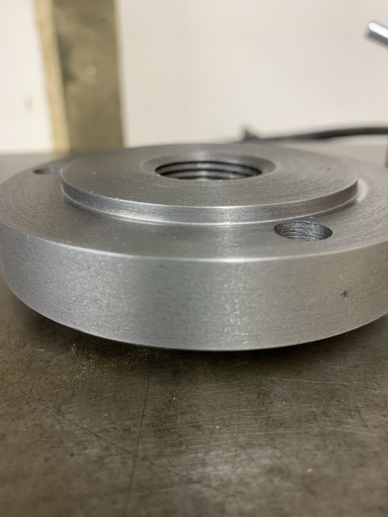

Richard Jarvis27/07/2021 22:05:49
25 forum posts
6 photos
I tried a dti on the backplate and found about 1 thou runout but the needle was constantly moving due to a bad surface finish. I will try to skim it tomorrow. Hopefully this picture will show the surface.eb6b87cc-2a19-4044-a230-45ed90234507.jpeg
brian jones 1127/07/2021 22:19:58
347 forum posts
62 photos
WOW the machining there shows a ripped finish (perhaps a Covid tool?). Hss should give a nice matt finish, no lube needed assuming grey CI 50 sfm

Have you checked the machining on the face plate?, I managed to get a better surface finish using a 12mm shank tool with what I think is a brazed tip. I tried a HSS but that left as bad a surface as original, that might be the operator at fault as I had attempted to grind it myself.
Richard Jarvis28/07/2021 13:04:13
25 forum posts
6 photos
Posted by JA on 28/07/2021 12:56:21:
Do RDG/Myford read these postings? Perhaps they should.
JA
Well they did not answer my last correspondence seven days ago so I decided to have a go myself with help from the group.
