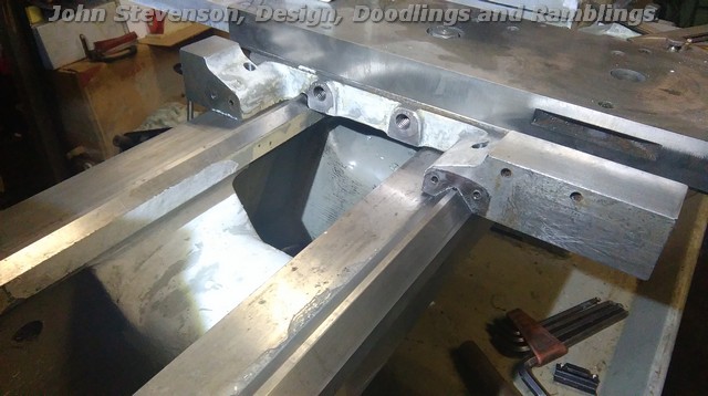

Murray, I'll get some pics from the back later today and post them. Yes the read head is at the rear and again mounts to two existing 1/4" Whit tapped holes in the carriage. I used a slice sawn off a generic scale bracket left over from fitting another kit.

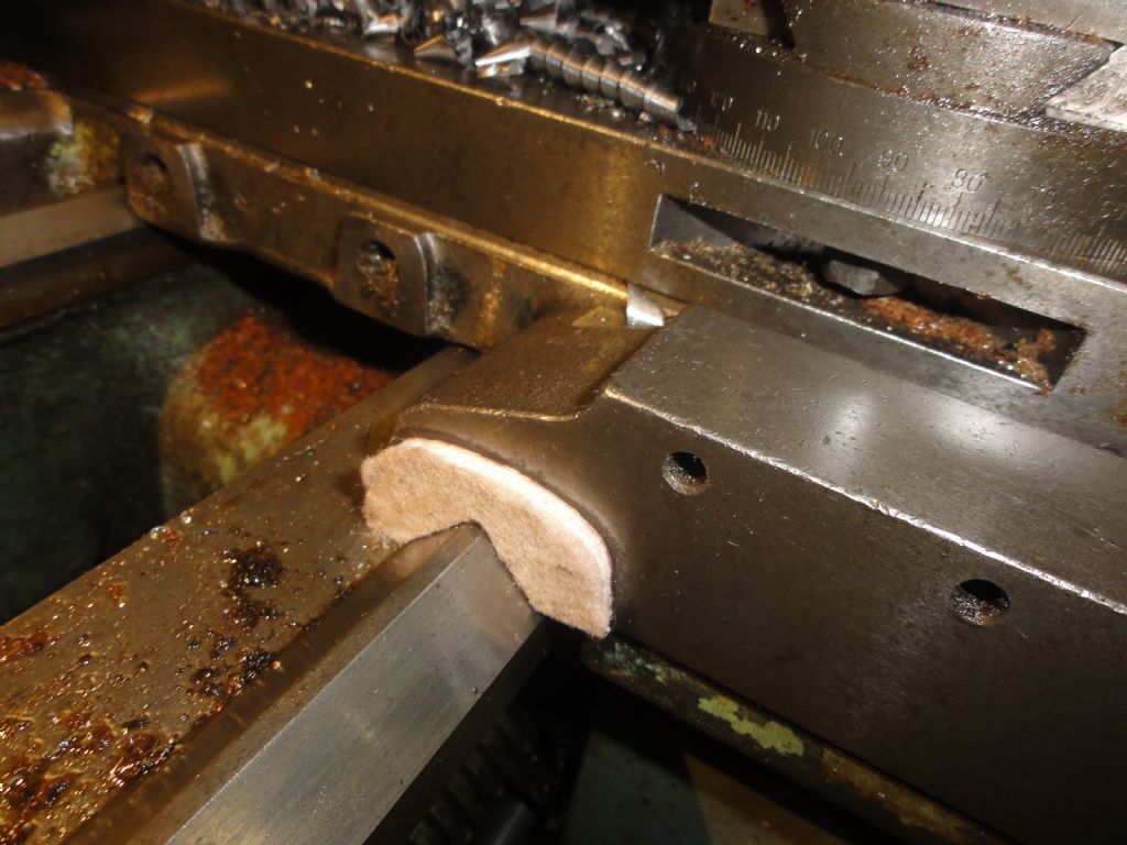

![]() 2904 forum posts 448 photos | In terms of wipers, what function do you think they should do? I can't completely convince myself quite what the ideal mechanism is. Should they be completely wiping the ways clear each time they pass, rather like a squeegee? Or leaving the oil but pushing the swarf out of the way? Or sweeping swarf out of the way and actively spreading oil on the ways? I would think the middle way myself but it's rather critical to decide which is best. The wipers that I removed had gone hard and possibly shrivelled, so difficult to draw any conclusions. Looking through some photos earlier I came across a couple of photos of the wipers I made using felt and a set of wood chisels and hole punches. To my mind they clear swarf but leave a film of oil. Murray |
Ady1 | 16/07/2015 01:23:52 |
![]() 6137 forum posts 893 photos | Looking through some photos earlier I came across a couple of photos of the wipers I made using felt and a set of wood chisels and hole punches. To my mind they clear swarf but leave a film of oil. Getting a bit boring I suppose but if you want to clean out your ways use your favourite oil mixed with colloidal graphite The crap just drops out, it doesn't allow anything to stick to anything Wipe the residue off your ways with a tissue and drop on a bit more CG impregnated oil We've all heard of penetrating oil over the decades, well this stuff actually penetrates |

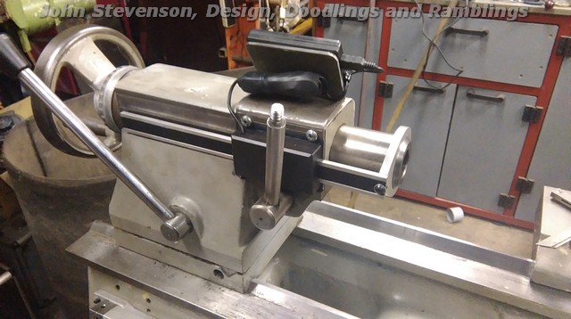

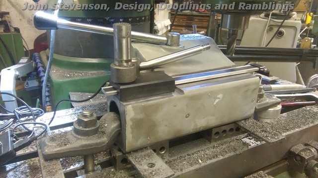

John Stevenson | 14/11/2015 21:48:49 |
![]() 5068 forum posts 3 photos | OK was in two minds whether to post this in the Bodgers Lodge thread or not, it's borderline so anyone of a nervous disposition need not continue further.

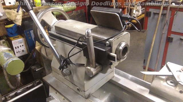

Rear DRO mounting finished and tested, no pictures unless needed as very basic. Next job is to fit one of the iGauging scales to the tailstock. Got these on the other 3 lathes and could not do without. Tailstock on the Bantam is squarish at the top so choice of 3 sides to mount it. Front mounted gets in the way of the top slide. Top mounted leaves it quite vulnerable so rear mounted looks the best and all the others are rear mounted as well and work well and out the way.

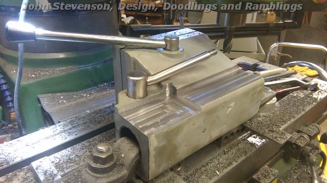

One problem on the Bantam is the barrel lock has a vertical spindle and there isn't enough room between to get the scale, so warm the spindle up at the bottom and give a slight tweak, better but still not enough and also the shape of the casting is not conductive to the scale following on.

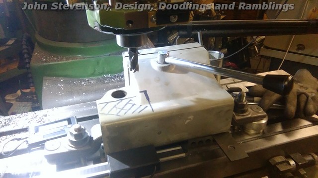

SO, stick it on the mill and after careful and very, very accurately marking out, remove the bit in the way.
Mill enough away so that the read head fits. Then follow up with clearance for the scale.
Offer it up for a test and jobs a good un. That broken bolt BTW is just holding the read head down so it doesn't tip. Plenty of clearance now.
Bit of a plate bracket and shot from the back.
And from the front.
That's as far as I got tonight as a hungry dog stopped play. Just need the clamp to go round the barrel and connect to the scale and poke the surplus of wire into a heat shrink sleeve and warm it up.
The whole lathe is also in for a repaint so all these mods will soon blend in.

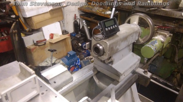

John Stevenson | 15/11/2015 22:12:10 |

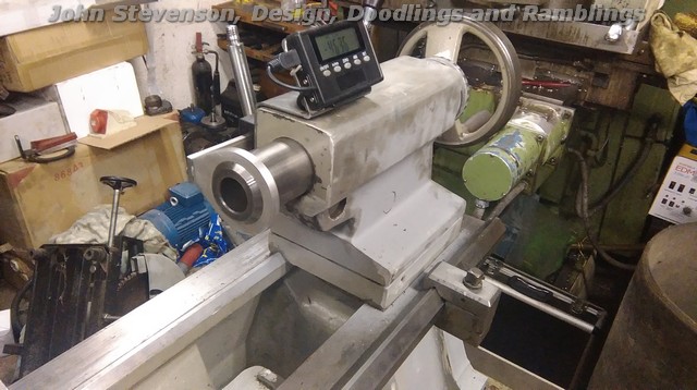

![]() 5068 forum posts 3 photos | Only managed to get a bit done to the Phantom Bantam today but got the tailstock finished.
Front view:-
Rear view with the wiring in heat shrink.
The bracket is drilled and once painted the cable bunch will be held with two cable ties for neatness.

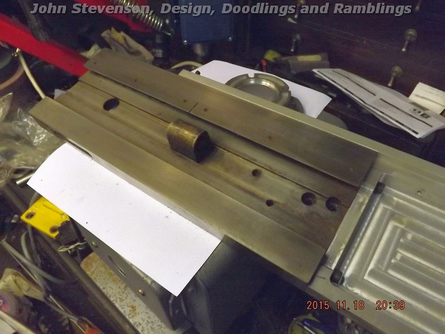

John Stevenson | 18/11/2015 23:39:48 |

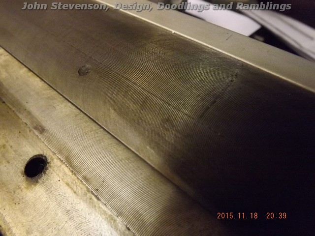

![]() 5068 forum posts 3 photos | So a bit disgusted tonight. Pulled the cross slide off to fit some ball oilers and this is what I see.
Nothing.
No oil ways, no method of getting oil onto the slides at all.
Then to add insult to injury this is close up.
Just a fly cut finish, no grinding, no scraping and the mating face is the same. I was under the impression that these were a class machine, far more attention to detail than the cheap imports ? Sorry, colour me pi$$ed off. Even a SC3 or a C3 has ground slides and ball oilers. So now got to spent the best part of a night scraping this in when it should not be necessary. EDIT. I suppose someone will say the fly cutting marks will hold oil and I must agree IF it was able to get oil under the slide in the first place Edited By John Stevenson on 18/11/2015 23:43:31 |
