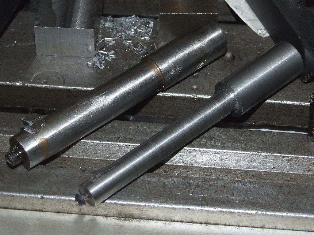

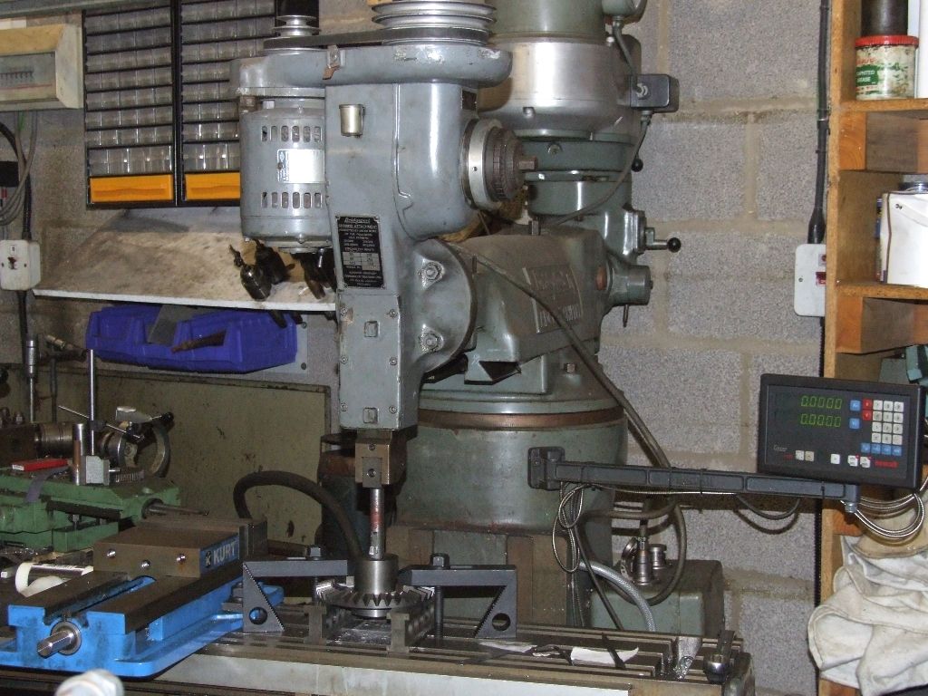

I was going to have a go at milling the worm for the steering gear on my traction engines today. The extra toolholder I needed arrived from the USA this morning. But, when I went to assemble the cutting tools, no 3mm endmill in stock. crying
So instead I decided to have a keyways-r-us day. Here's the basic set up with the slotting head:
The only iffy part is swivelling the ram on the mill through 180° to swap the milling and slotting heads, while avoiding the shelves on the right. Here are the tools I used:
I made the tool at the back ages ago by milling a slot in the end of the bar and brazing on the cap. If you look closely you can see the joint. I made the tool at the front today. The slot for the toolbit was drilled each end and then filed to fit by hand, as I didn't think there was enough metal for a proper brazed joint. The cutting bits are ground by hand from HSS blanks, using a micrometer to check width. The smaller (1/8" ) bit at the front was easy, as I just happen to have some 1/8" x 5/16" HSS offcuts.

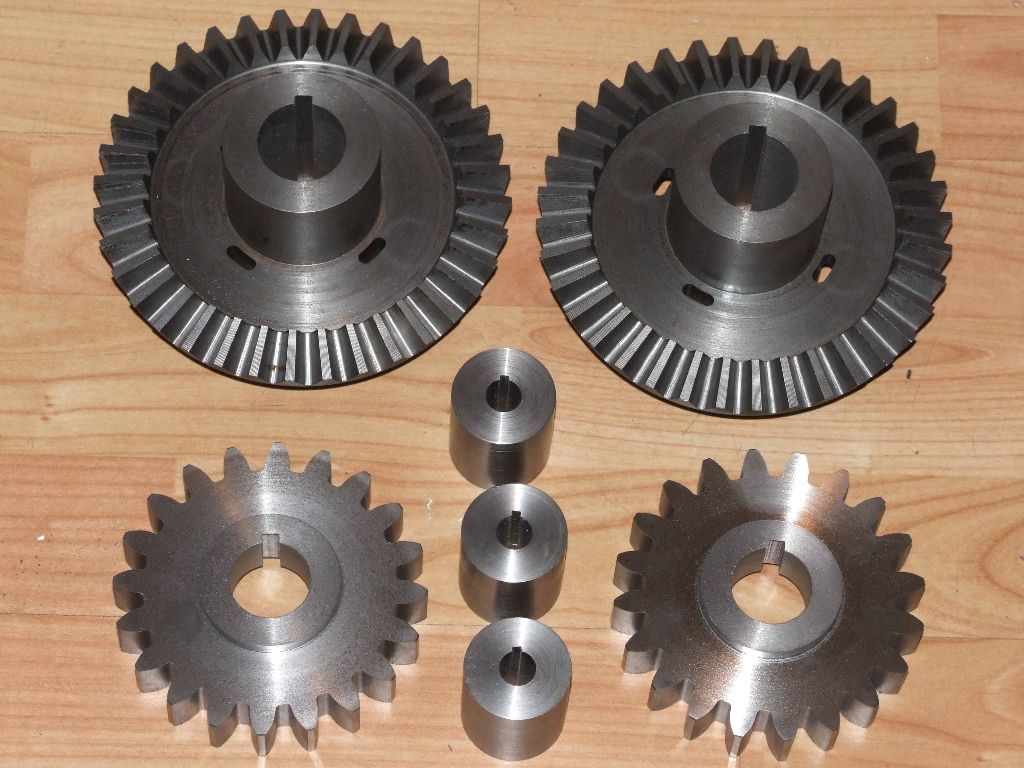

Here are the parts in which I've cut keyways today:

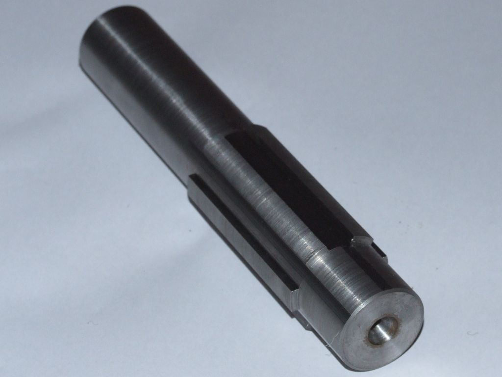

Cut a keyway, and cleaned up the edges, on my home made spline cutter, now ready for hardening and tempering:

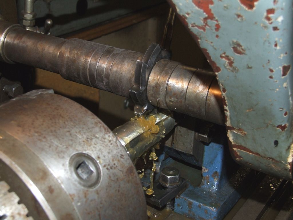

Hardened and tempered my home-made spline cutter today. It was pre-heated at 500°C, then raised to 810°C and left to soak for half an hour. I don't have any quenching oil, so I compromised and used brine. After hardening testing showed it was at least 65Rc. It was then tempered at 210°C for half an hour, and quenched in brine again. After tempering the hardness had reduced to around 61Rc, pretty much where it should be for the tempering temperature.
This evening I cut my first test spline with the cutter. I choose a conservative speed of 67rpm, giving about 55sfpm and a feedrate of 28mm/min, about 2 thou per tooth. Here's the cutter in action:
And the finished spline:
The core is supposed to be 1-1/8"; on every opposite pair it measures 1.125" at one end and 1.126" at the other. The splines are supposed to be 5/16" wide, ie, 0.3125". They all measure 0.309"±0.001". Good consistency, but a bit undersize. Never mind, I can adjust the width of the tool used when I cut the slots in the mating gears.
