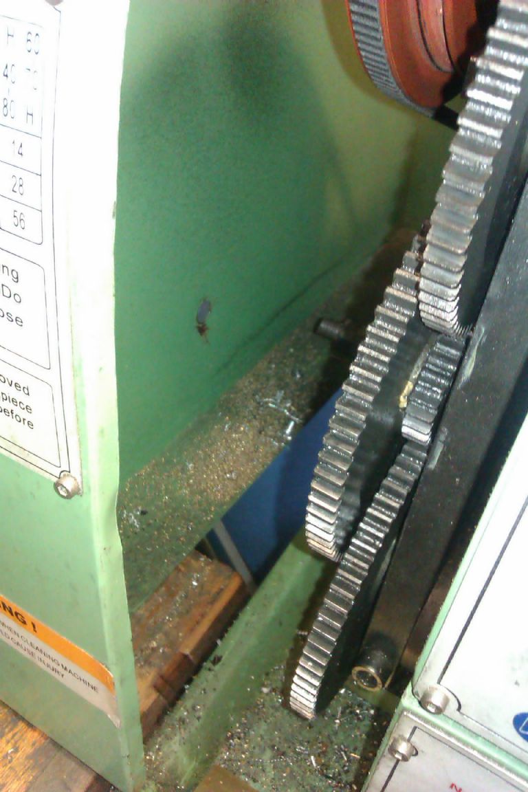

Re tumbler revers, just stop flick the switch into reverse and thats it, you can even give the speed knob a tweak and back out faster than you went in. But as you say for occasional screwcutting its not an issue
Stuart, the end cover does not hinge, you unscrew two knurled knobs and move it out about about 25mm and can then lift it up, I'l have a measure & take a photo in the morning of the exact amount of space needed, 250 may be a fraction less than my 280.
Also if you can afford the extra get the 250 with power cross feed.

Well took my cover off and noticed that there is actually a short return to the bottom of the cover, this means you need approx 100mm to the left of the lathe to allow the cover to be removed enough to slide it up. If you wanted to shorten teh studs and put a notch in teh return then this could be reduced to 50mm but you do need room to get yout hand in to unscrew the knobs,
Takeaway12/02/2013 10:51:32
108 forum posts
Thanks for that Jason, exactly the detail I need to make final decision, very much appreciate your efforts and pics. - Best regards - Stuart
