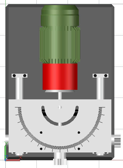

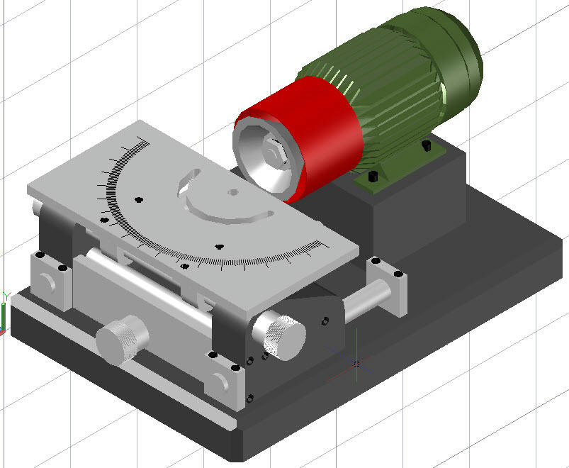

John McNamara21/05/2011 18:03:29
avatar
1377 forum posts
133 photos
Hi All
Maybe the easiest way to consider what changes are made using mineral casting is to try redesigning a known design.
The Warden design Grinder is a good starting point. A simple machine made from sheet metal.
In the drawings below the base, Motor support pillar and the sliding end plates have been redesigned to use Mineral castings.
The Base is a 50mm cast slab all mounting holes will be placed by casting in pre drilled and counterbored 50mm long sleeves of mild steel, the outer surface of the sleeve to be knurled or slightly ribbed in the lathe; this will remove any possibility of them being driven out. Light 8mm steel reinforcement will be placed around the periphery and in a 100mm grid pattern.
The motor pillar is a solid cast block that will be epoxy resin glued to the base. This will form an extremely solid mount for the motor. Epoxy Concrete has about 8 times the damping of cast iron and a great many times more than that compared to sheet metal. This should greatly reduce vibration and improve the surface finish obtainable. I chose to draw a .5hp frame size motor, although there is room for a larger rating if required. I provided for a taper lock removable wheel mount so that multiple wheels could be easily changed and remain centered.
While reviewing the sheet metal design I decided to make the table movable in both the x and y direction. In addition to the angle Z plane. Note the two knurled knobs for adjustment. These would turn simple feed screws loaded against a spring to remove any backlash.
Note the thickness of the end plates, provisionally 50mm, this allows 25mm holes to be cast in for the round shaft rails. I deliberately chose this size to get a large bearing area. As cast the clearance will be between .0001 and .0003. The gap being the release agent applied to the shaft to stop it sticking. This is where cold casting really excels. Alternatively precision bushes could be cast in or bush retainers if you want to take a belt and braces approach and have replaceable bushes.
The table is 12mm steel Supported on steel bearing blocks screwed to the underside transferring the table load to the 20mm steel shaft that runs between the end plates. The end plates again greatly improve damping (The table angle adjustment cams are not shown I want to review that design)
This is a concept design it is not finalized, however it would not take a lot of work to make it so, unless inspiration takes charge forcing a redesign.
The casting process is no different to working with cement. The aggregate mix of 5-8mm graded aggregate, ideally rounded pebbles  and washed silica sand for the base and coarse washed silica sand only for the end plates is mixed with approximately 9 – 12 % Epoxy by weight. Ideally less is better. This week I take delivery of the epoxy I have chosen to test. I will report back my findings.

NJH21/05/2011 19:54:26
avatar
2314 forum posts
139 photos
Hi John
No Philosophy please - we've had rather too much of that lately!
I assume there will be a need for a mould to cast the base and some form of jig to position the sleeves ? Forgive me - my only knowledge of this type of thing is occasional (very reluctant) work with concrete in the garden where precision is not an issue.
You promise a very solid and durable framework. How are the costs likely to compare with the traditional model?
I rather like the CAD drawings.
Cheers
Norman
Paul Boscott21/05/2011 22:44:16
avatar
99 forum posts
21 photos
Hello John
That's much more in the spirit of the discussion.
Good 3D solid Cad drawings posted on line. The way forward. Now if we were to use a plastic 3D printer to create the mould. We would only be a few years behind what's going on.
Paul
Chris Trice21/05/2011 22:50:52
avatar
1376 forum posts
10 photos
I can see some drawbacks. You can't cut or machine any of the castings without destroying your cutter. Not many cutters, short of diamond, mix with sand and stone. Presumably the epoxy mix needs to be vacuum degassed too? watching your results with interest John.
John McNamara22/05/2011 09:16:30
avatar
1377 forum posts
133 photos
Hi All
I have been thinking about the moulding methods rather carefully. As the materials arrive this week and I will be starting to get my hands dirty. Something I like very much. It is great fun to get through the design stage, but the real fun is when the idea takes physical shape.
The method of casting depends on the accuracy required in the finished part. Unlike sand casting where a 5 to 10mm or more allowance for roughness that needs to be allowed for, and must be machined off later, we can get good accuracy straight from the mould.
If you have a surface plate pre waxed and additionally protected by a polyethylene sheet. We do not want to damage an expensive piece of kit like that. We should be able to get flatness better than .001inches provided the surface plate is true.
I also have a piece of kitchen bench top granite… A sink cut out; most kitchen companies have lots of them. They are surprisingly flat to better that .001.  OK that is a generalization the one I found was flat to within .001 tested on the surface plate.
In the case of the Warden grinder in reality this kind of accuracy is not required for the base. Considering that the sheet metal version base is likely to have errors an order of magnitude greater in the .1 to .01 range… OK although certainly not optimal for the design. The sheet metal base does have two ribs however as an open shell it must flex under load.
My plan to make the form work for this project is to use Melamine coated MDF I have to hand for the base… I plan to make the base upside down so the top surface will lie against the bottom of the mould the 50mm strips forming the sides creating a tray to contain the mix will be screwed on to the base
The chamfers will be formed by pieces of timber or ideally plastic beading obtained from the local hardware and glued in position. I have no plans to reuse the mould so no draft to allow removal has been used. The mould will be destroyed upon removal. Commercial users of this process make multi segment metal moulds. There is nothing to stop us from doing the same if the need arises.
The Motor support column can be made in the same way, just a simple cube.
I have been warned by a friend in the Boat building industry of the pitfalls of using Silicone mould release if you plan to paint later. It is almost impossible to completely get the material off your casting and will seriously frustrate your paint finishing. The boat builders use Carnauba wax or commercially made silicone free products. Your resin supplier will have them.
All mounting points should be cast in position… Two methods come to mind for this, one to drill through holes in the mould and screw the inserts in position from the back this will keep them nicely planar to the surface of the finished product.
Alternatively if extreme accuracy is required solid metal inserts could be prepared and glued in position to the mould walls. They can be marked out, drilled and bored by conventional machining methods after the casting has cured. With a little planning the second option should not often be required.
This is what the micron level machine builders do. They also precision grind the mounting ways, including the cast in screw inserts.
A third alternative is to cast in, holes using say Styrofoam blocks; we want the holes to be rough inside preferably with a little undercut for a good key for the next operation; they can be picked out and washed away with solvent later... Then we can “cast in” this time using an epoxy grout, a precisely positioned mounting. The accuracy achieved will be directly proportional to our ability to pre position it.
Shrinkage: I have not mentioned shrinkage because all of the literature I have read over the last six months that I have been researching states it to be negligible. Even if so Gravity alone will obviously affect the finished casting, as will applied load forces, Temperature and many others.
It is important to mention here that Epoxy resin and Polyester resin systems are completely different. Epoxy resin has two parts and good quality epoxy does not have added solvents. Polyester resin systems as used in boats for instance in addition to the catalyst use solvents in the cure process. They shrink as the solvents evaporate and are totally unsuited to our need for precision machinery; as is conventional Portland cement even worse and the tensile strength can be regarded as negligible due to micro cracking.
The two end supports for the warden need a little more work in preparing the mould.
There are a number of through holes; the inserts for them need to be exact length 50mm in this case to match the 50mm width of the casting.
That leaves the 25mm nominal hole for the guide way shaft. I plan to increase this to 30mm. I will then position and cast in the round rail later using a bearing mix. Please see: “epoxy bearing material and method” posted on this site.
Alternatively others may prefer to cast in steel inserts and later fit bronze bearings. There will be no trouble holding it for machine the existing holes can be used to screw it to the setup you use to hold it.
In both cases a core of the correct thickness to provide for this will need to be screwed into the mould. It is fascinating to consider that if we place that core in the exact position we can have confidence that finished part will be accurate.
Continued next post ...........
