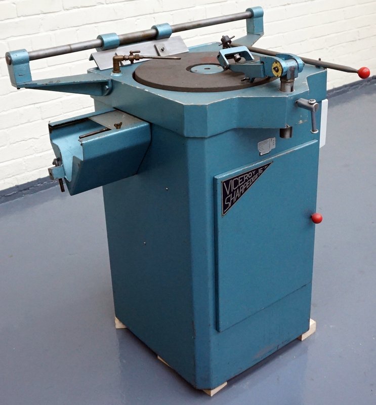

You’re obviously much younger than me. The only bench grinder in my School was in the metalwork shop. The woodwork shop used a large flat rotating oil stone for plane blades and chisels. A friend of mine is a technician at a school and they still use one of these, a Viceroy Sharpedge. You get a traditional flat grind with it not the hollow grind you get with most modern grinders. The Japanese sell a much smaller unit that uses water instead.

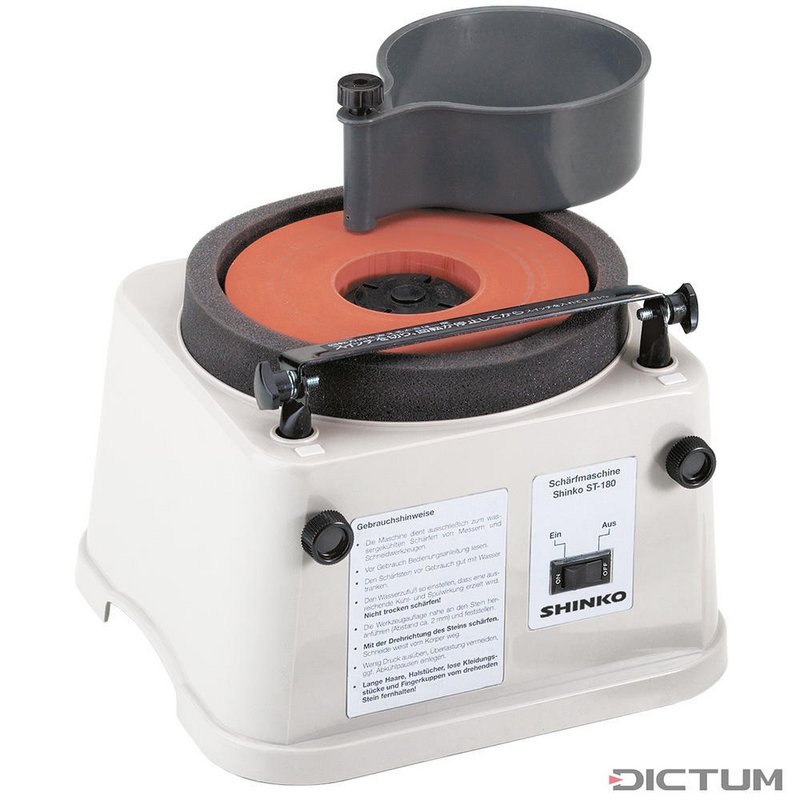

Re the "Japanese" machine, the similar ones I have seen do not recirculate the water and, more importantly, I had doubts about their electrical safety. The rotating stone seems similar in composition to the conventional Japanese water stone.
They are certainly capable of putting a keen edge on chisels, etc and a planer blade attachment is available.
Belatedly, but I did not see this reply before: I forgot to mention we rubbed the plane blades on a bench oil stone after initial grinding on the bench grinder. This put a narrow, flat, finely honed face along the edge of the hollow ground area, achieving the same result as sharpening on a flat stone as you describe. We were graded on A. How well we had made the initial hollow ground surface on the bench grinder and B. How well we had oilstoned the small flat surface to form the final cutting edge. I imagine this was the way plane blades were sharpened on the job by carpenters and cabinetmakers since time immemorial as rotating flat stone machines were not something most small workshops would have had.
