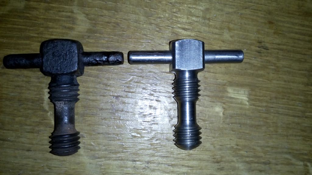

Today I made a 1/2" BSW screw with a 9/16" square top and a 1/4" crosspin for hand-operation. I centred and drilled the crosshole 6,0 mm, then followed up with a little-used 1/4" Dormer as a Dagenham Reamer.
The cross pin was 1/4"" silver steel, miking up as about .2499/.2500" on a Mitutoyo Vernier mic.
I still had to turn the crosspin down to .2490" in order to bash it into the 'ole with a Thorex 712, and I don't think it'll fall out any time soon.
