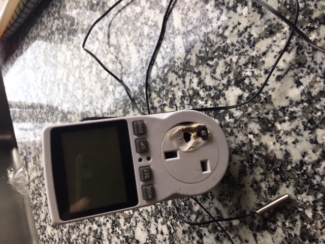

Not quite Steve, but I am wary of the spec in many cases.
I bought a thermostatically controlled mains switch which was rated at 16amps (3.8kW). The appearance suggests not but...
I ran it with a load of 2kW and the functionality was fine for a while, then the photo says all - not to be left unattended!
I find much of the Chinese stuff works fine unless you start to get over, say, 50% of its rating the switched dc so-called PWM modules are a case in point. Thus, I often only get a bargain if I use Chinese stuff and beef up the output i.e. I could only use the thermostatic switch at 3kw if I use the output to operate a properly rated switch, either solid state or contactor/relay.

A great deal of truth in that.
You are unlikely to buy one of the MCBs in question from RS or Farnell. You will pay more but, at my age, I should realise by now, you get what you pay for (mostly!).
This applies to my thermostat really. wink
