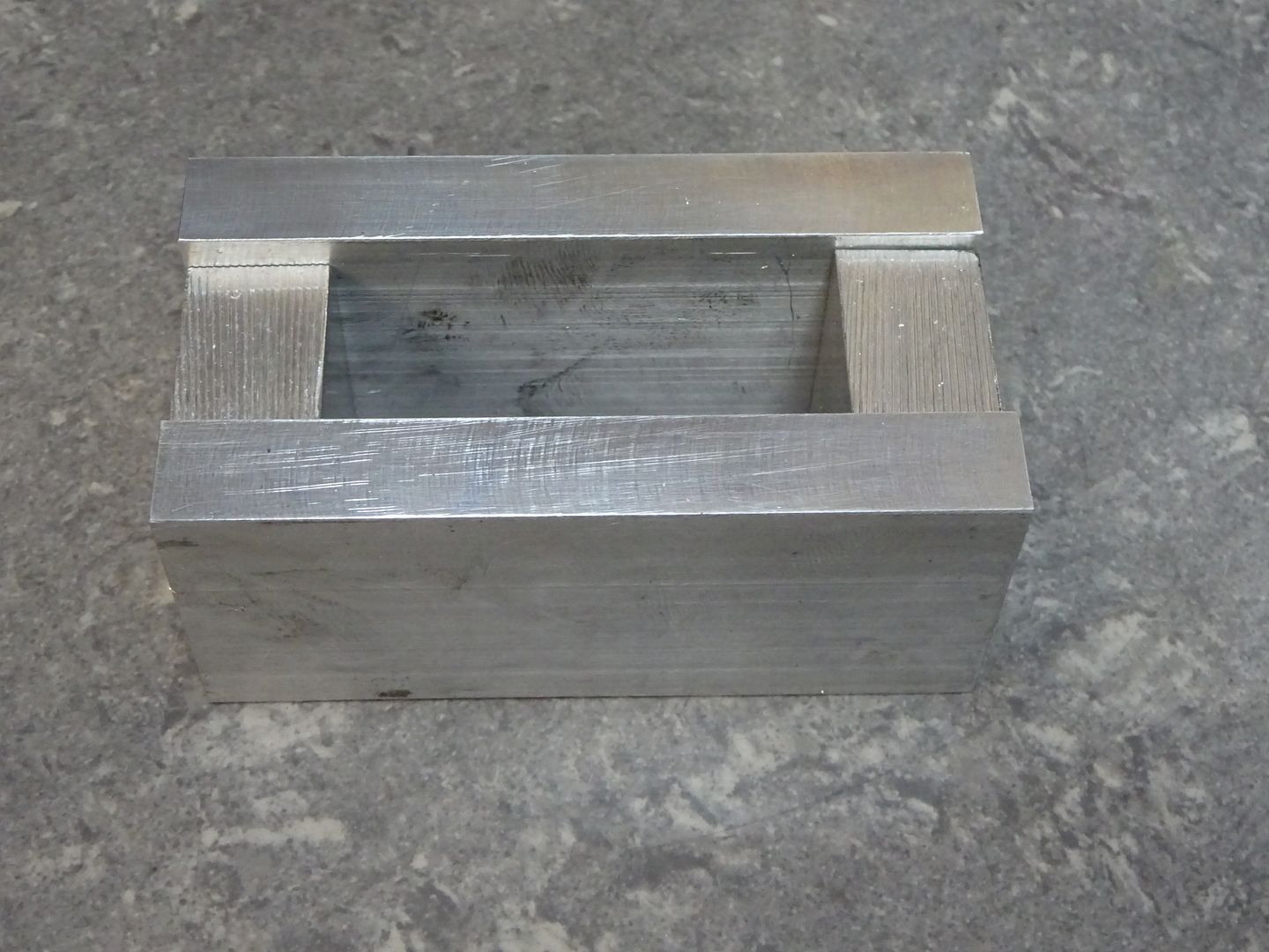

I had a bit of a doodle of teh Victoria base casting and my thoughts on costings were about right. To buy two base castings will set you back £122 plus postage from Stuarts. They could be made in the sa,e way as the vertical I pictured above for 1/4 of that, aluminium would be £20 and say £10 for some M3 cap heads and a tube of JB Weld, less if you used steel flat.
Make the basic frame parts

Drill and tap the cross pieces and drill & counterbore the sides then screw together with a smear of JB Weld. Then a bit of milling to form the pads for various parts

OK, so I'll fabricate the box beds - I suppose when I buy the plans I can scale them if there are no external dimensions. The 10V box bed drawings have no dimensions apart from hole centres - not even an overall height.
What would be the best setup method of machining the draw and raised base on the sides, to reflect the casting?
Do you put JB weld on the face-to-face interfaces, and sand back?

Plans show the machined features but easy enough to get overall sizes and thicknesses.
For this one I would make up the basic frame and then the ends can have the draft and moulded detail added by holding at an angle in the vice, the sides would need the underside of the vice packing so that work is therefore at an angle. A flycutter could be used as could a corner radius milling cutter or just use a flat ended milling cutter and add an internal fillet with filler. Have a look at the base of this engine being built.
Yes a smear of JB Weld on the mating faces. Use car body filler to add fillets to internal corners and fill the screw holes as it's quicker to sand than JB Weld.
