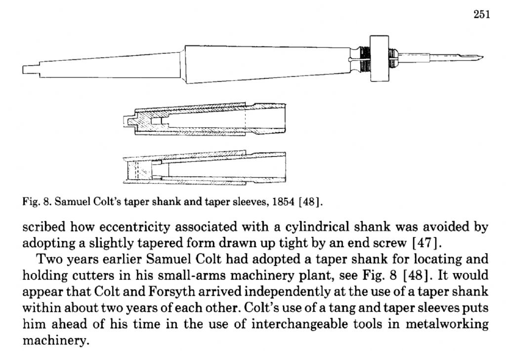

Michael Gilligan16/09/2020 16:16:55
avatar
23121 forum posts
1360 photos
Posted by SillyOldDuffer on 16/09/2020 11:47:45:
Tried and failed to find the original US Patent, which might reveal all. Possibly Michael Gilligan could apply his famous search-engine super-powers and see if he can find it?
Back in February 2019 [see my earlier link to the prequel thread] ... This was the best that I could offer in response to ndiy:
[quote]
Posted by not done it yet on 11/02/2019 08:26:08:
Look guys, I know the drive should be friction between the tapers, but answer me this: Why was a tang fitted ...
The definitive source of information would be the original patent ... but I have yet to locate a copy.
What I have learned, however, is that the taper drive with tang was patented by Samuel Colt, before Stephen Morse patented his drill.
Ref: **LINK**
https://books.google.co.uk/books?id=mkoSDQAAQBAJ&pg=PT130&lpg=PT130&dq=morse+taper+shank+patent&source=bl&ots=oJYnUYVVTC&sig=ACfU3U1OYvbO47dqoJ1JUE_dl7bZF5XpIg&hl=en&sa=X&ved=2ahUKEwiitPDvrbPgAhWt6uAKHa2ADZsQ6AEwGXoECAkQAQ#v=onepage&q=morse%20taper%20shank%20patent&f=false
[/quote]
I’m not really all that interested, but it looks like a search naming Samuel Colt might be more fruitful.
Edit: But I have just found this reference:
[48] S. Colt, British Patent No. 861, 1854.
Edited By Michael Gilligan on 16/09/2020 16:40:13

Patent documents can be a good starting point. Be aware, however, that whilst everything written in a patent document must be true, the whole truth is not a necessity. Likewise, the necessary features must be shown completely, but other related but inessential features may be omitted, to another scale, or adjusted to avoid disclosing helpful aspects unrelated to the invention as such. I would always take care, especially with seemingly detailed drawings of which the victorians were great exponents. (Speaking as a 40 year veteran of this stuff)
Michael Gilligan16/09/2020 17:11:58
avatar
23121 forum posts
1360 photos
Posted by john halfpenny on 16/09/2020 16:48:16:
Patent documents can be a good starting point. Be aware, however, […]
Duly noted, john yes
The best I can offer is this [which may, or may not, be copied from the patent]:
Note: I sincerely hope that this small extract counts as ‘fair quotation’ from the source document.
Ref. https://www.sciencedirect.com/science/article/pii/0378380489900752
Edited By Michael Gilligan on 16/09/2020 17:13:46

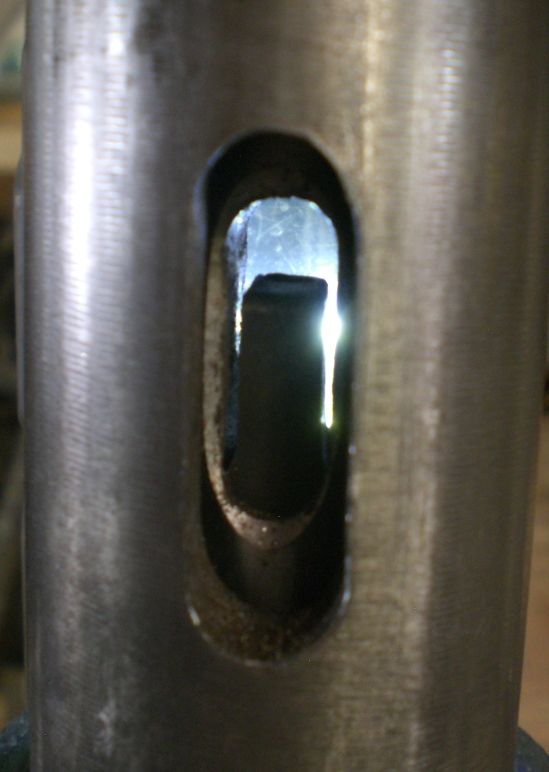

Nicholas Farr17/09/2020 19:19:24
avatar
3988 forum posts
1799 photos
Hi, if the tang was designed to be driven or even partly driven, why is it not tough enough to resist twisting and wringing completely off? I don't believe it's there as a warning or any kind of safe guard, as by the time it's wrung off and the drill bit stops turning, it is already starting to do damage inside the quill and this will accumulate the more times it happens.
Tang#1
They are not particularly hard as you can use a file on them without any real trouble and who would design a drive dog with such a sloppy fit, as the chances are if it started to turn in the quill, you would get an impact load onto the two opposite corners of the tang and that to me is not good engineering design.
Tang#2
The drill makers tell you that the tang is for ejection purposes only, so why don't people believe them, and I'm sure manufacturers don't make their machines with abuse as a given thing to do by not keeping tools in good order and not discarding damaged ones.
Regards Nick.
