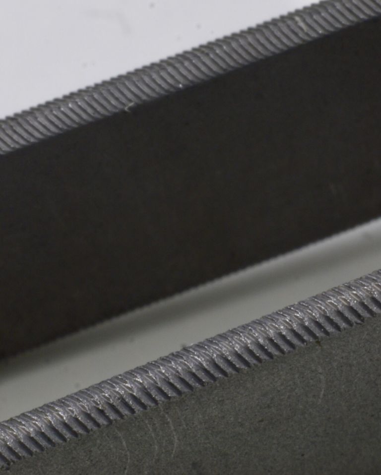

Interesting question, Nigel
Are you sure that there isn’t some confusion with the traditional file ?
**LINK**
https://www.cousinsuk.com/product/slotting-screw-head-1850-vallorbe-swiss
That looks an odd section for cutting slots in screwheads although that's what Cousins describe it as.frown
Ian P
If you want a flat bottomed slot, change files to finish off.
As per Brian’s link ... These are the ARC ones [which have ‘half round’ edges]

When multiple heads come next to each other in a row I use a slitting saw to make the slots, it is a much neater sight when they are identical. With only one screw head a piercing saw with the correct blade thickness will do fine. If the head becomes very small when the thread is below M 1.0 a piercing saw with the smallest thickness of blade is best to use. A screw-head file is much too wide that work. Niko.

First observation is that you'll never get a pretty slot using a saw with set on it. So using hacksaw blades whether they're wavy set or a normal wood saw with side set ain't going to cut it, if you'll excuse the pun.
The slotting file is the right tool, and I seem to remember correspondence from Ketan a few months ago saying he'd bought some - inadvertently - and were they of interest. Might be worth a call. A slotting file is a thin file with no teeth on the faces, but teeth on the edges so it cuts sideways - or downwards if you hold it on edge.

The ones I linked to were "joint square edge" Michael, as I assumed that the slots should have a flat bottom.
Brian G
EDIT:  Sorry Michael I finally grasped what you meant, follow the saw with a slotting or round edge file then finish off with the square one.

My apologies, Brian ... The ones that I bought from ARC, and photographed, were ‘joint round edge’
