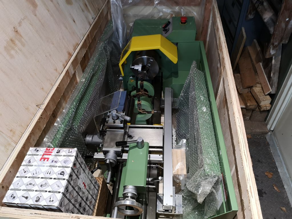

Now I'm really scared! The boat docked last week and today Warco had it presented to me on a platter, er I mean pallet. It just about fit in what's left of my so-called garage. All I can say is Wow! Unfortunately I'm about half way through a flu-like living hell (had my jab so no complaints there) and the last thing I fancy doing is spending time outside in the cold so it will have to wait. At least I can now satisfy my curiosity about the sizes of AXA, BXA and CXA toolposts and potentially order the right one, assuming I measure correctly.

For the moment, I would not worry too much about Q C Toolposts. You can live with the four way. quite well.
You may find a Back Toolpost more useful for Parting Off. If you don't buy one, you could make one. (I made a fourway indexing Back Toolpost for my lathe, just to be difficult)
(Should make for some interesting turning! Hopefully, the deal includes a Four Jaw independent chuck, which will be extremely useful?) That, of course then leads you down the path of buying a clock or two, one a Finger Clock, the other a Plunger Clock, and either a Scribing Block or a Magnetic Base.
You are on the slippery slope already! But the kit will always be useful.
Find and join a Model Engineering Club. You will not only find advice, very likely practical help, and probably someone who will either lend you odd accessory that you need, or come round with theirs.
Riding one of my many hobby horses, do ensure that the bed is free from twist, to avoid inadvertent turning of tapers.
Enjoy yourself!
Howard

Terry, welcome to the 280/290 club, I find it is a useful size for real world stuff, and the ability to knock up custom bearing drifts and pullers is a massive boon for maintenance work on full sussers with their myriad bearing types and sizes.
My 280 has even managed to recreate some busted hope ti hub flanges with the help of a rotary table.
The 280/290 has very little room on the topside to fit in larger toolposts and tools, I remade one of the rotating clamp parts between cross and top slide to fit a T1 sized Dickson qctp, and 16mm tooling. Otherwise I think 12mm may be the limit.
As for supplies of stock you are in luck, even for small bits postage becomes the overriding cost, so local is almost always cheaper. Jenkins steel, in Cramlington are an eBay steel seller, often selling off cuts from their engineering side, I have bought from them a few times now, and they seem a good bunch.
