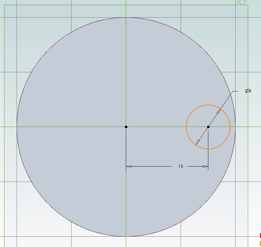

Can someone please put me right on a question with atom3d? I have downloaded and installed the program as per MEW 274. I followed the tutorial and felt sufficiently inspired to tackle something more complicated. I drew up a crankshaft for a four cylinder engine that I'm designing. All seemed to go ok except I can't get the crank pins in the correct relative position with respect to the crank webs. The circles in sketch mode are restrained to the grid and I can't find any way to edit the centre coordinates. Nor for that matter, any of the nodes. The grid and snap to grid options are both deselected in system preferences. I've tried searching the internet without success, hence my appeal here. In essence, I want to know how to alter the properties of an individual part.

If you have turned snaps off, just apply dimensions in the sketch to move the circle centres to wherever you wish.
You should be able to drag the circle centre to get things roughly where you want.
If more convenient, you might be able to use sketch constraints in place of (for example) zero dimensions.

John on the sketch of the crank pin what colour is the circle, red, orange or black?

David,
I'm sorry, I don't know what you mean by "apply dimensions in sketch" nor the term "constraints". They don't have the same connotations as in my current cad package. Can you elaborate a bit, please?
Jason,
The circle is black.

John if you go to the "sketch options" box and click "toggle sketch dimensions" it should then show the distance your circle is from the two axis. Now use the select icon and you can double click these dimensions and alter them.
The fact your circle is black means it is "fully defined" that is you have set the diameter and set its position. Snapping to grid would leave it red or orange if you had just set the diameter.

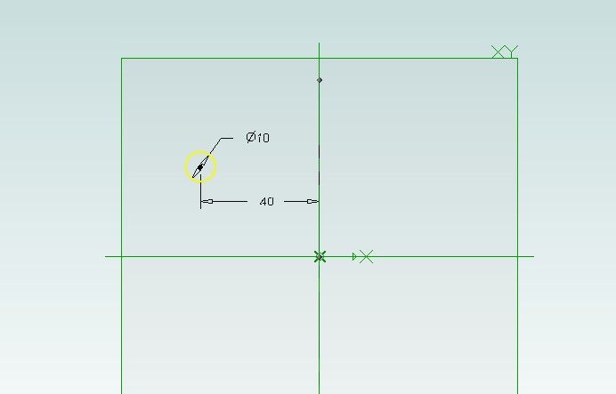

John,
Others have at least partly covered this - this image shows where to find the dimension tool and the sketch constraints.
In this one I've used a dimension to fix the distance between Y axis and circle centre, by clicking on the axis, then the circle centre (with dimension tool active).

John - as Neil points out, you have to re-enter the sketch to make changes; right click on the sketch name in the 'Design Explorer' (on left hand side of screen) - then choose 'Edit' to get back inside the sketch.
Most 3D Features are based on a Sketch, features are built up to form your Part.
Your crankshaft probably consists of several features, each with its own sketch defining the profile.
