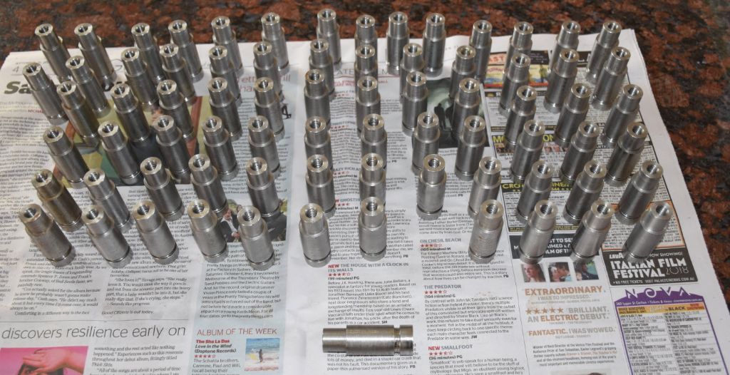

Hi All
I am working on a new CNC Mill made from Mineral castings, (10-12% Epoxy and Graded aggregate).
It requires about 250 steel inserts of various types.
Many are tapped M6 and M8. I broke an M8 tap today, annoying, I don't break taps very often. The material is the problem it appears to have hard spots. Because of the number I used the lathe to power tap the thread, it has clutch reverse so reversing out is not a problem. Had I not already machined the inserts I would have used leaded steel. It was too late for that. A 30mm thread is required for design reasons not strength so I decided to ream the holes out to 7mm yes this oversize for M8 it should be 6.7mm. The result was no more broken taps and clean threads.

Andrew Johnston26/09/2018 18:42:37
avatar
7061 forum posts
719 photos
Posted by John McNamara on 26/09/2018 16:10:47:
No wonder you're breaking taps, 6.7mm is far too small. For M8 I'd drill 7mm, or even 7.1mm, to start with.

Howard Lewis26/09/2018 19:32:40
7227 forum posts
21 photos
Using the rule of thumb for Metric Coarse, Tapping drill = (Nominal Dia - Pitch) The smallest tapping drill should be 6.75 (* - 1.25). So 6.8 would be the smallest. Ordinary oil is not really suitable for the pressures involved in tapping.
7mm drill will decrease engagement, but not enough to worry about; many folk advise it to avoid just your problem.
But DO use a proper tapping lubricant. Works out a lot cheaper, than buying new taps and the wasted time, effort and material of having to remake the piece when the tap breaks in the last holes (as it always does).
Since the tapping will throw up a burr, either chamfer, counterbore, or overdrill the start of the hole..
