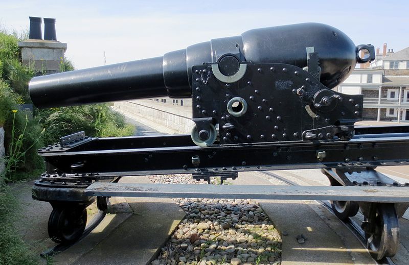

Hi
First of all thanks for all your advice. I will look for a piece of cored bar as Hopper suggests and then use the drill extension that Rod and the others have mentioned.
It is a through hole and it is for a cannon barrel. I am probably going to have a go at the type shown below.
It needs a through hole so I can put riffling in it, the breech end will then be blocked up with a screwed on cascabel. The real ones had the cascabel screwed into place also.
Thanks again.
Rich

Whether rifled or not, best not drill a touchhole through to the bore unless you're putting the finished cannon onto a Firearm Certificate. Near where I used to live in Redditch, someone had a model cannon destroyed by the police and I don't know whether they escaped prosecution.
How are you proposing to rifle it? That seems to me the most difficult process to do at home.

Is it an Armstrong gun?
Button rifling the cast iron barrel might be quite fun to try.

As it is non working I wonder if it might be easier to make in two parts with the chase from smaller dia stock that could then be screwed and loctited into the reinforces. Assuming the whole cannon is going to be 12" long that would make each bit about 6" which would be a lot easier to drill and you could just riffle the chase which would be long enough for anyone poking their finger in the barrel to think it goes all the way.
Buffer11/05/2018 13:17:30
430 forum posts
171 photos
Jason
Thanks for the advice. I could build the barrel up over a tube then I won't have to drill my hole at all. It would just be a few fat stubby bits needing a hole. Also if I mess up something I wont scrap the entire job.
